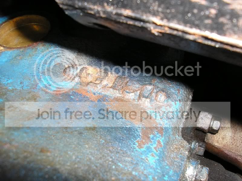

ok here is a picture of the casting number, tonight hopefully when I get home from work I will get some pics of the spark plugs...and the engine
here is the casting number pic, i tried to make it out the best i could, I'll clean it up
Ford Truck Enthusiasts Forums - Reply to Topic
see now when you look at it looks like D8TE-1 with no A1A or A1B
so im so confused ?

I copied it and flipped it to try and see better but I can't make out the 2nd character (alleged 8)
If I stare at it long enough I think it is a 6.
Can you use a wire brush on it and take another pic?
sometimes using a bar of soap drawn acoross it will highlight it better as well.
also, look for another 3 or 4 digit casting number with * Number | Letter | Number | (possibly another number) *

I need a positive ID on that 2nd character.
I also need those other casting numbers.
