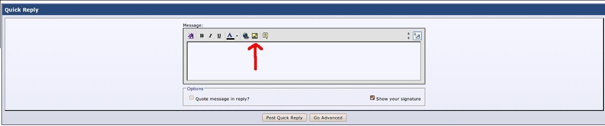

Posting pictures has gotten LOTS easier... if you use what they gave us...
Click the mountain/sun icon in the advanced editor window, you can drag-n-drop from your computer or browse to it/your device as well as insert a URL to externally-hosted images.

I do not see any mountain or sun icon. But I will have to go to the forums later and read how to post pics in my usercp and gallery again. In the past it was just copy and paste or insert. Now they want URL and assortment of other things.
I'm not one of the real computer savvy persons.
Thanks for the help.

The same icon exists in the Advanced mode editor:
