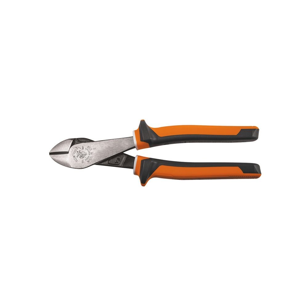

I have a great tool for fixing aftermarket alarms systems and has been 100% effective for me, looks like this:
wire cutter

Many thanks, Sam I Am, your hunch was a good one. I have never used alarms in my cars, so the name Prestige meant nothing. I thought it was a brand of after market FOB.
I looked and found a motion sensor installed in the car, and in googling that particular device came up with a couple of possible alarms, one of them being a "Prestige" alarm.
Where the car is parked, I can't take the time to use a tool like the one you suggested, so I am going to use a different tool across the contacts of the starter Kill Relay. This will allow me to start the car and move it into the garage, where I can have good lighting in order to use the tool you showed me, and do the surgical removal of this nasty critter.

It would be great if you could upload a video to Youtube of you using a paper clip on the starter relay.
That's going to hurt.
And it might even weld the paperclip to the relay.
You could remove the alarm system or you might try to figure out how it works. With miles that low the system is still likely very fresh and functional. After all, it works so well you can't even "steal" it with the key. There may be a sequence of clicks on the fob that arms it to deactivate the starter. Find the control box, get a part # and look up the instructions for it.
