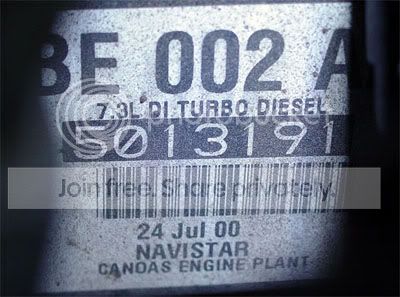

Ok, I know the "supposed" change over is on 10/16/2000. I have a 2001. The catch is, my engine tag states a July 24 2000 build which would be way before the November 2000 change over. Here is a picture of my doortag:

And my engine tag:
The orange sticker on the other side states it's got 250HP which means it is the 2001 model engine (Because they pumped the factory HP that year). I purchased he truck from the original owner (Old fella) and hell it's only got 27,000 miles on it so I know the engine/tranny are original. So what do you guys think about the engine having forged rods? Not that I really care as all I do is drive back to work and haul 9k every other weekend. Just wondering

we say it over and over. if it was built before 10-16-2000, it has forged rods.

Originally Posted by DavidT.
And my engine tag:
And his engine serial number is 5013191?

Why not just pull the plug out of the side of the engine and look? That would erase all doubt.

Right, just like I stated in my original post. However, I was like Orezona and always looked at my door tag not my engine tag.
BTW strokin did you get your suspension leaning figured out yet? Check my post, it may help : https://www.ford-trucks.com/forums/s...d.php?t=473742
Kwik, I just searched that option...looks like when I have more time this weekend that's what I'll do
