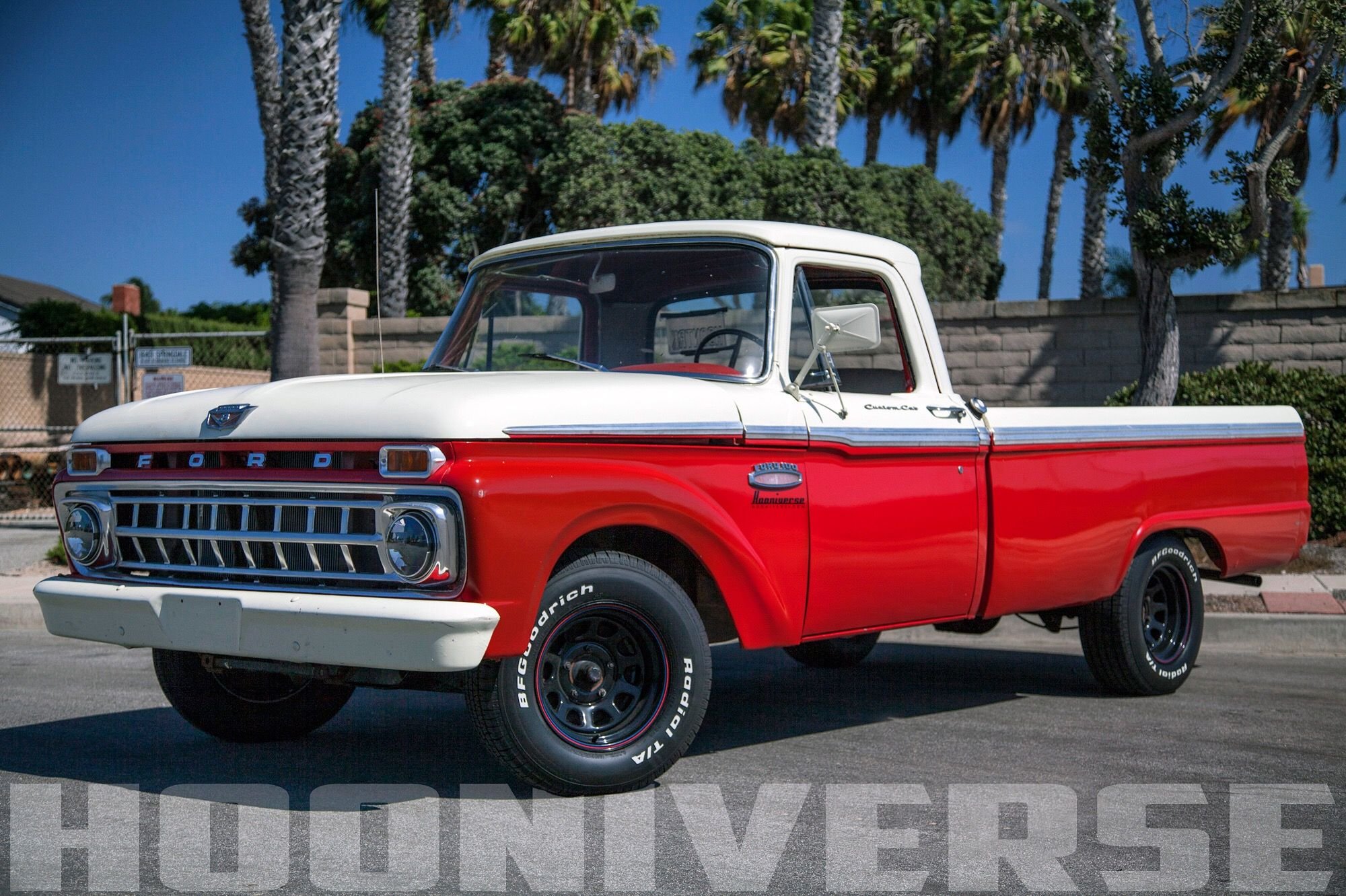

Here's how she looks at the moment. Going to get the driveshaft sorted soon, redoing the wiring, possibly adding a Hurst, and then upgrading the brakes
Here's how she looks at the moment...
