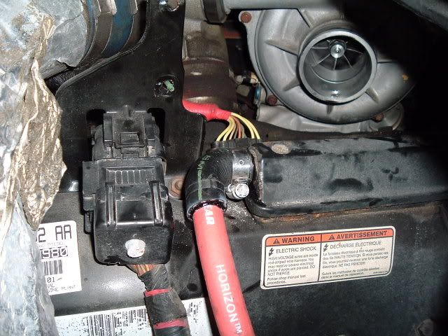

I'm with Bird Dog, I need a little more info on the whole Mod. No offense strokin_it7.3 but I'm not sure wire nuts and superglue are right for me.

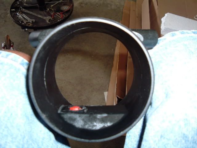

they have held up for 5-6 months for me, no problem. believe me, a 16 year old, i cant have this truck in the shop because of something broken, (that is why i got a 7.3 instead of a 6.oh ) and i check everything frequently. i like to get under the hood and just play. a sandbox without sand.
http://img.photobucket.com/albums/v3...t/DSCF2106.jpg
http://img.photobucket.com/albums/v3...t/DSCF2098.jpg

After seeing your pics strokin_it7.3, it makes a lot more sense what you were talking about. I didn't want to imply your way of doing the mod was questionable, I was just unsure about the wirenut and superglue. Thanks for the pics and ideas on how to complete this mod.

The only suggestion that I make that is different from strokin, is to replace the entire black plastic piece (that the CCV originally vented into) in the intake with a piece of exhaust tubing. I took the whole thing out and couldn't believe how restrictive is is. A piece of exhaust tubing has to flow a lot cleaner and more air. And, if you're going to have it out to plug the hole, why not just replace it? It also eliminates chances of a leak in the intake that would be after the filter. We all know how the dirty air can kill our turbos.
There are pics in my gallery of the CCV mod and where you can see the exhaust tubing I used to replace the stock plastic piece.

That piece of 4 inch diameter exhaust tubing is 3-1/2 inches long. Any decent muffler shop will have some of it laying around, and should cost you less than $5.00.
Best part is: It's not plastic!
