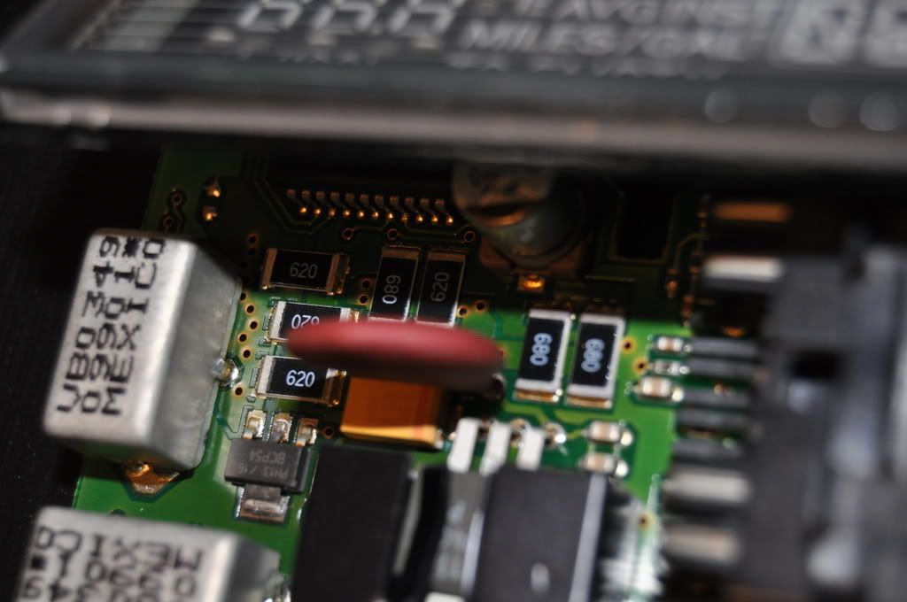

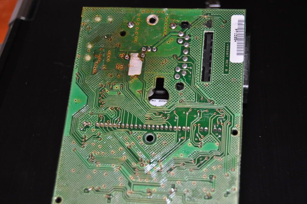

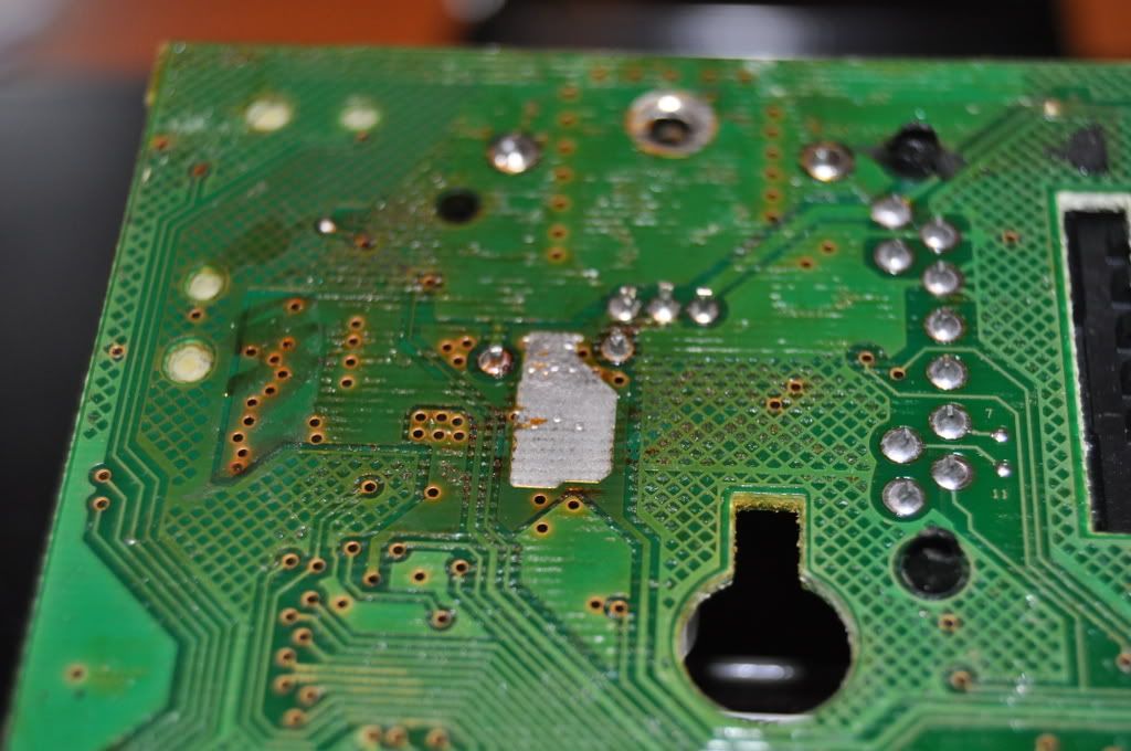

I know this is a very old thread but running a search, this is one of them I found.
I have seen the links with the pictures of some bad boards where they needed to be resoldered or have a replacement resistor soldered in but I have a question.
My board works if I "twist" it by grabbing each corner and sometimes even works for a few seconds when I let go. This leads me to believe it is a loose/bad solder joint. Problem is, everytime I hold the board and push in on one of the resistors (per instructions from other threads), the board lights up regardless as I am "twisting" it again. Should I try and resolder everything? I would prefer not to as there is more of a chance I could mess something up. lol None of the resistors "look" bad but here are some not so great pictures.

I don't know about resoldering everything, but for sure all the places on that board where it's been overheated.
