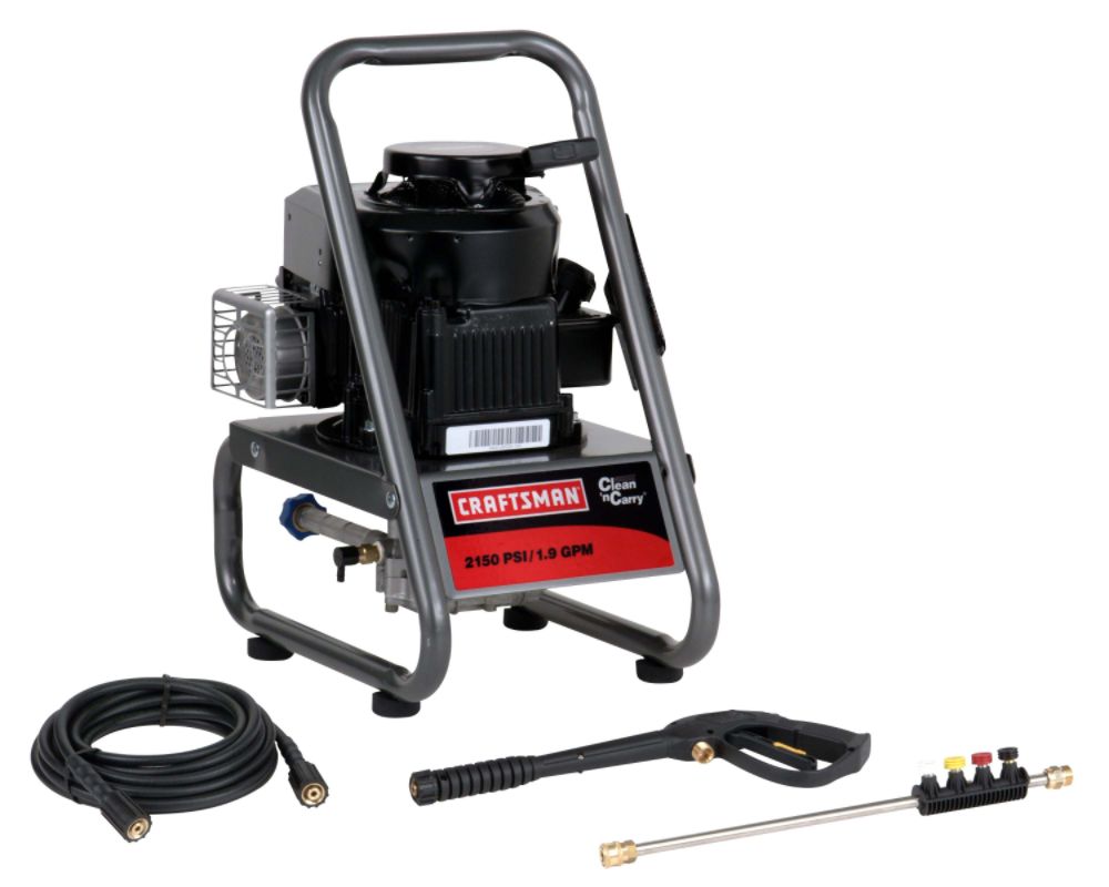

i would go gas, briggs and stratton makes good ones. stay away from the oil less pumps. the briggs are still made with an italian made pump that is filled with oil, it is also rebuildable. the best deal out there right now is the craftsman clean and carry it is made by briggs. nice setup 2150 psi 1.9 gpm runs 199.00 on sale or 270.00 off sal
