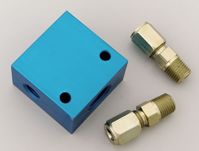

You could use one of these if you dont want a remote filter.......
