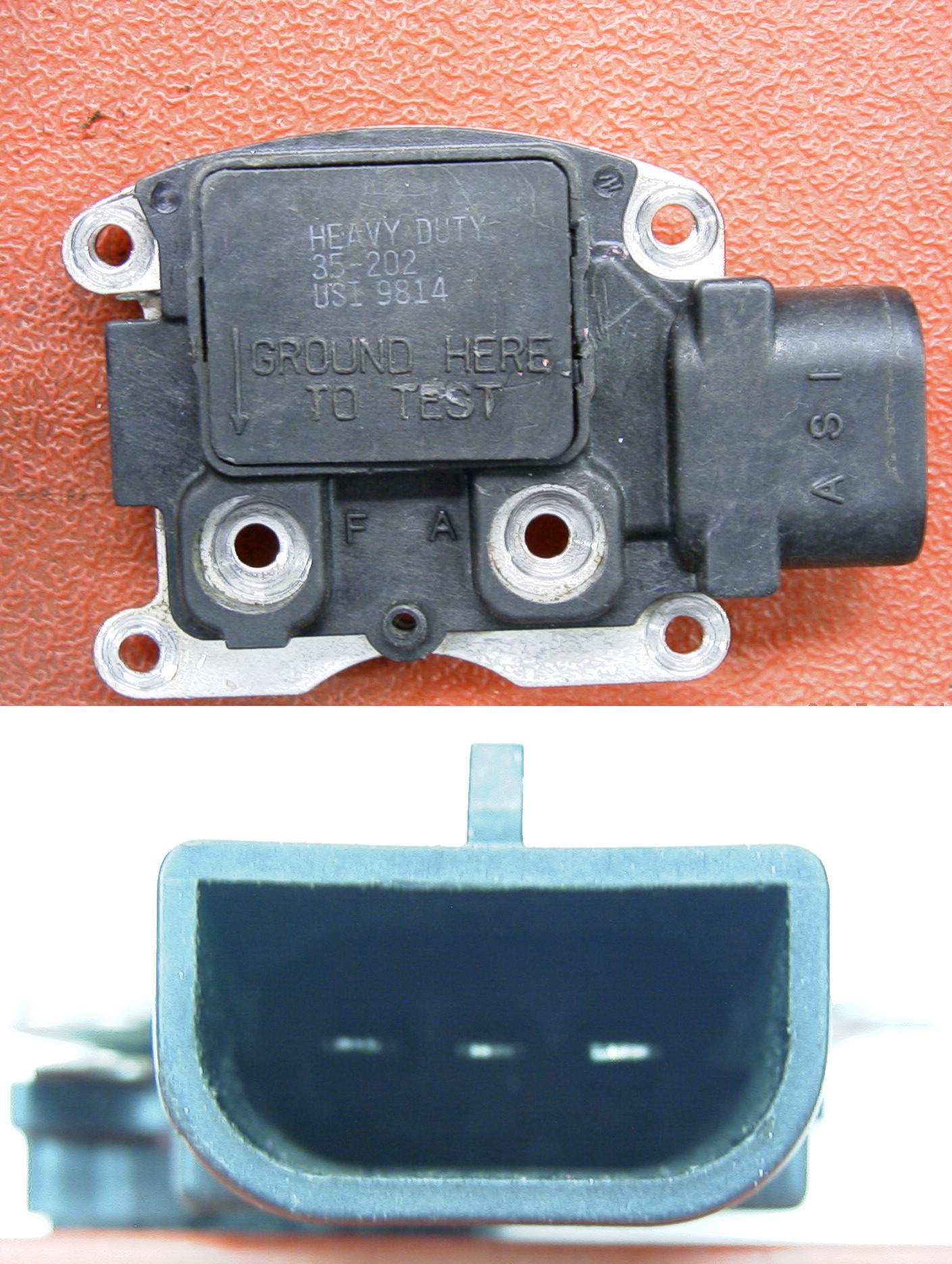

Old Jun 12, 2005 | 10:42 PM
asavage's Avatar
asavage
FTE Community Team
Joined: Nov 2001
Posts: 1,855
Likes: 260
From: Oak Harbor, Washington
Originally Posted by copper_90680
Yes, the voltage regulator is part of the alternator. But, lucky for us, the regulator is mounted on the outside of the alternator and easily replaceable. Just two little screws (or is it four, I don't remember).
I just had my second one die tonight (overcharging again), and yes, it's four:
You have to remove the four outside T20 Torx screws to remove the regulator from the back of the alternator. Don't remove the two screws on the center; they retain the brushes holder to the regulator, and if you remove them, the nuts will fall into the alternator (ask me how I know).
In order to reach the lowest screw, I had to remove the belt and the adjustment bolt to allow the alternator to swing way up.
This is an aftermarket regulator; the OEM one is grey and says, "Motorcraft" on it.
