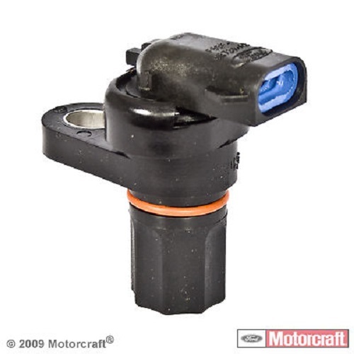

Thank you for the reply. We found an article stating that the sensor was on the differential and we were able to find it.
Since I was having some other work done, I had the mechanic replace the old sensor from a new one that I got from it last week to no avail.
Cruise control hasn't worked in years. I don't know about the ABS, but I definitely don't have overdrive.
ALSO -- the airbag light has been on for years.
The "sensor" that we changed looked like this one.
https://i.ebayimg.com/images/g/o~AAA...bom/s-l500.jpg
