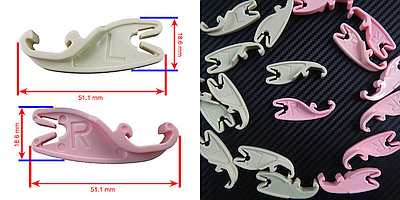

My ride is 24 years old and besides the door cable ends I've had to replace the plastic "lock pawls" on the front doors. They attach the door lock to the lock rod. When it breaks the door lock turns but does nothing. Better get a set on hand now before you need them. There is a right hand/left hand part and most sale them in pairs.
I found mine on ebay, 5 pairs for about $5

That should do it. Easier and cheaper than changing the cable.
