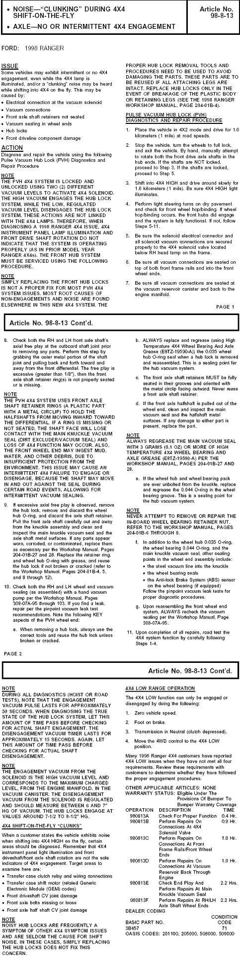

You can't assume it's always a hub or a wheel end problem. You have to look at other things, too. I referenced this TSB before, it has a comprehensive diagnostic procedure for the PVH system:

Here is the Ford Factory Manual "Wheel End Vacuum Seal Test" that is refeenced in the TSB:
NOTE: Whenever the front wheel hub, axle shaft or the hub lock is removed and installed, the front wheel-end assemblies must be leak-checked to ensure that the sealing surfaces are intact. Failure to do so can cause the loss of four wheel drive operation and contamination of the vacuum system.
1. Disconnect the wheel-end vacuum hose.
2. Connect your hand vacuum pump to the PVH vacuum hose.
3. Apply 15 in-Hg of vacuum to the wheel-end assembly and observe the reading for thirty (30) seconds.
4. The wheel-end assembly must not leak more than 0.50 in-Hg in thirty (30) seconds.
