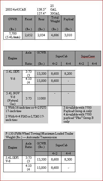

that should help. it is for the F150/7700, which should be the same as the F250SD, all for 97-03.

https://rvsafety.com/images/pdf/FordTG2003.pdf
