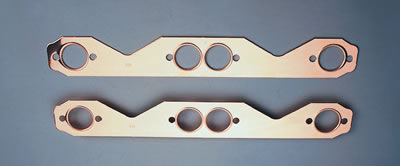

Also, I would look into a set of copper header gaskets such as the sce-4035 (summit racing's part#).
