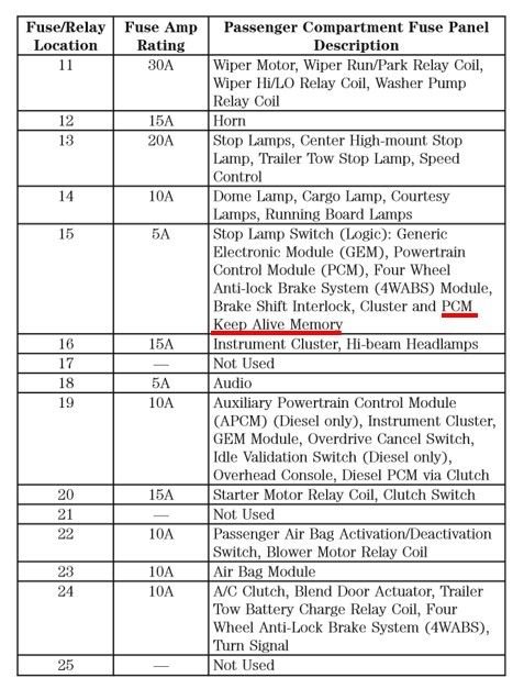

But back to the Relays, I don't hear/feel them click when I unplug them or plug them back in, so I'm assuming that the PCM has another power line somewhere else to keep it's memory?

It does. There is a keep alive circuit for it. I would not think you would lose the PCM memory by pulling the PCM relay given that.

The PCM already has what's called "Keep Alive Memory" supplied at all times by the battery. Removing the PCM relay will not clear the codes or reset any monitors as the relay only supplies power to the PCM when the key is in the run or start position anyway.
