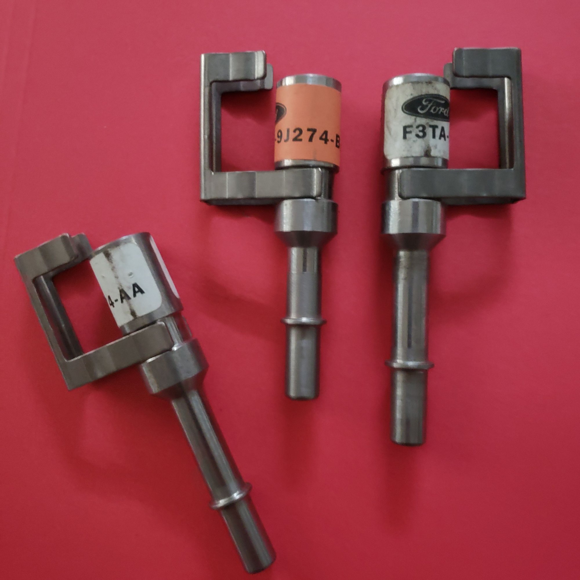

Post 2 has it
New gas tank
3 pumps later on a 04 I had; I finally installed one of these Ford one way valves (recall valve)
You can get these from the aftermarket these days, but they are expensive
Old Yesterday | 08:24 AM
manicmechanic007's Avatar
manicmechanic007
Joined: Jul 2020
Posts: 10,478
Likes: 2,636
From: Near Salt Lake City
Look up recall 93S49
That pertains to your truck for the same problem and the one way valve failure in the pump
That valve will both hold fuel pressure and stop crossflow
