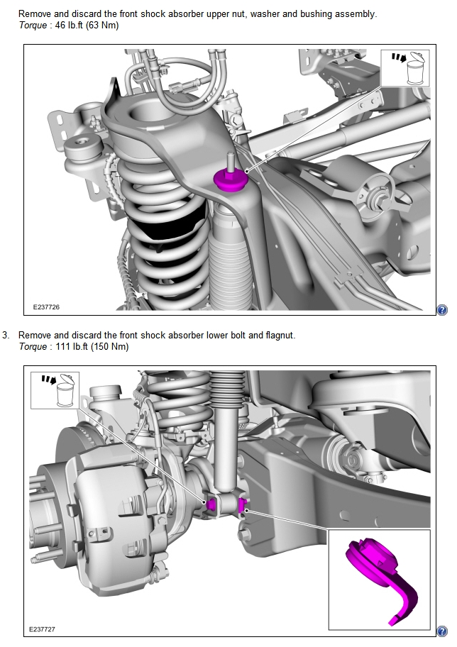

Anyone know where I can find torque specs for 2025 F250 shocks?

I doubt it's changed. Bottom bolts are 111 lb.ft the tops are 46lb.ft

[QUOTE=seijirou;21838183]I doubt it's changed. Bottom bolts are 111 lb.ft the tops are 46lb.ft
[/QUOT
These are great, got anything for the rears?
Here you go.
