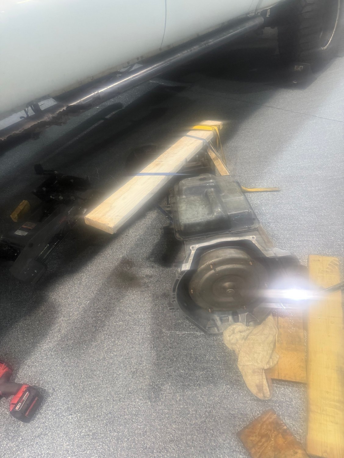

the problem for me was using 1x6 to support the transmission on the outer rails without 2 braces in the middle to prevent them slipping inward. Once that happened there was not enough height to reinstall so I pulled the whole operation out. Unfortunately with the limited straps and wood after re setting it on the jacks it flipped over. Couple more straps and it would have not occurred.
Have removed both at once before you need 2 transmission jacks or a ATv/moto jack on the transfer case. usually support the 2 independently not on a long board as shown in the photo. Ended up using a sawzawll cutting the board allowing room for the transmission support.
