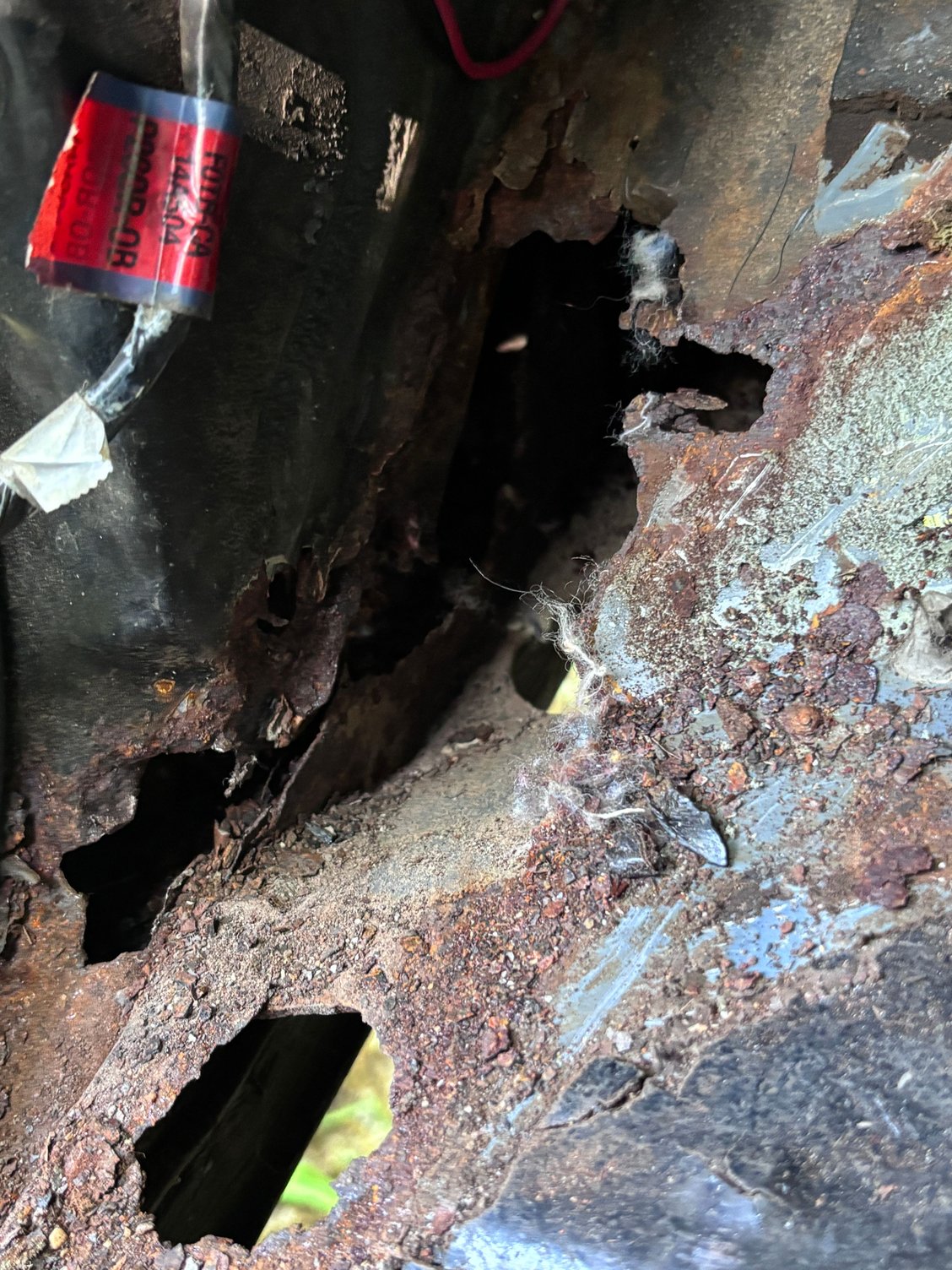

1990 XLT standard cab, I pulled the carpet back after removing the kick panel to pull the ECM and was greeted by cancer
I have ordered a replacement floor panel to cut off what I need but I can figure out what panels I need for the inner dogleg and that split you can see in the hole just above the cab support. The support is good and the rest of the floor rot is localized to the door sill trim screw penetrations, I’m just going to form some patches and weld them in.
Any assistance in defining what panels I should grab would be appreciated. I am no stranger to welding, just can’t seem to find a clear breakdown of how the cab is assembled.

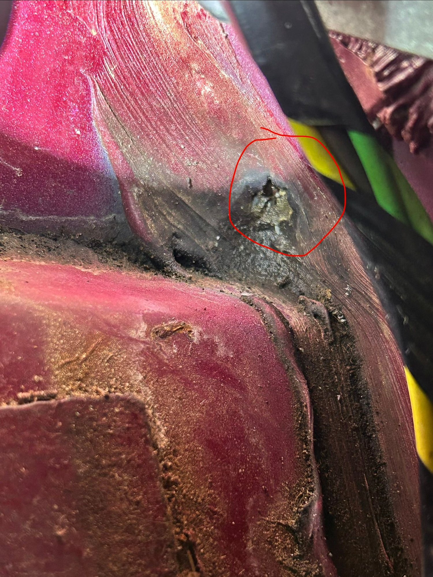

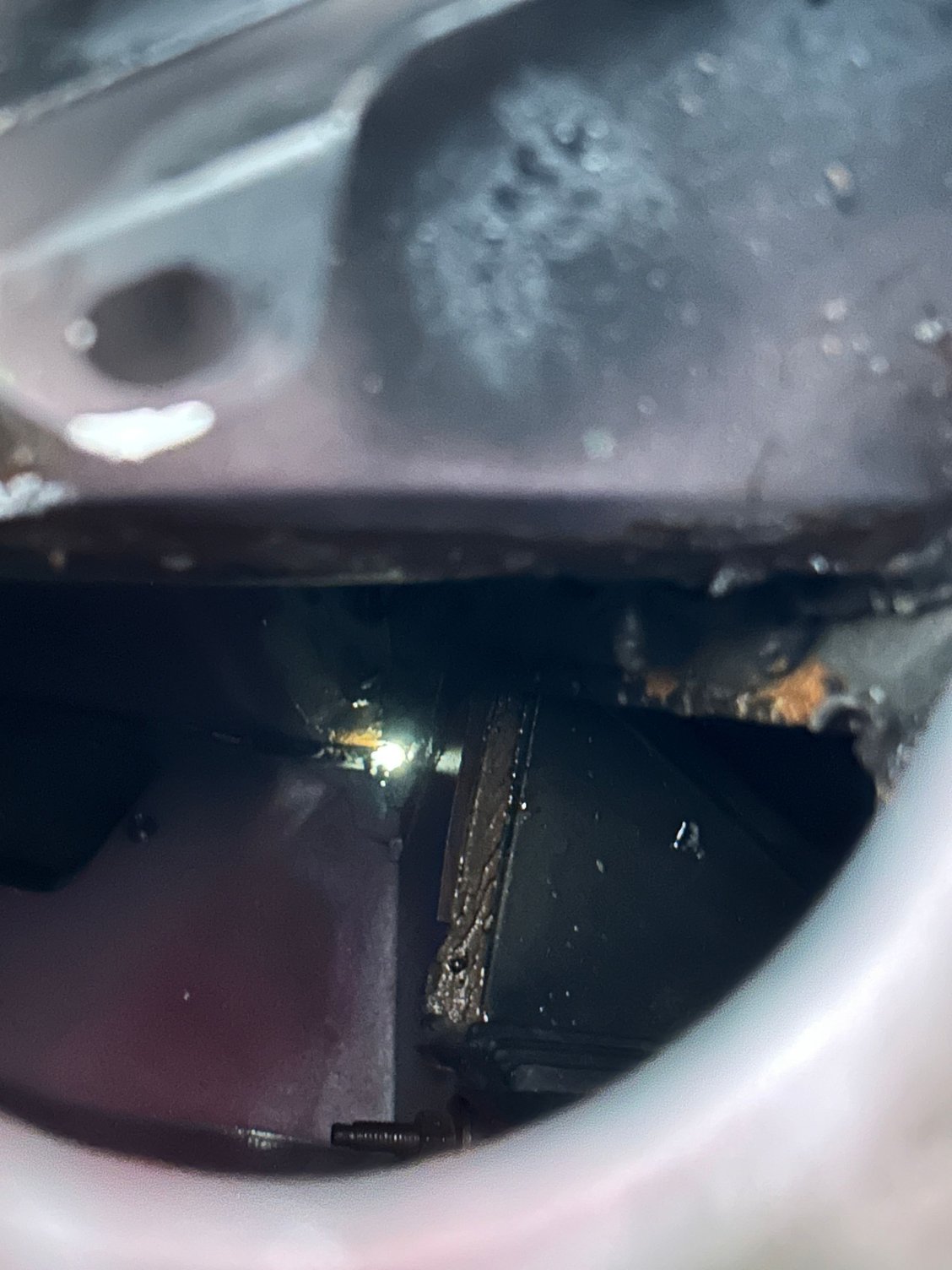

Reseal your whole cowl area!! Your rusted out area is exactly where my broken cowl seal was leaking on the driver side. I also had it leaking on the passenger side as well. Pull the hood cowl, remove as much of old as possible and reseal all across top and down inside pockets between cab and fender through the holes. If you don’t have small hands/arms, it sucks! I sealed it, let it dry over night and then used a water hose to find where I missed. This happened 3 times haha! That’s why I say to use the whole tube and cover everywhere the first time.
i know nothing of body work to answer your questions.
Drive side where computer is.
Inside passenger footwell
Flashlight from inside driver side looking down hood cowl (removed)

Thanks for the heads up! I’m actually planning on pulling the cowl cover soon, I have to replace a seized wiper motor. I’ll schedule that work first before I get into the floor replacement, no sense fixing the rot and still letting water get in on top of it.

For S and Gs, once you remove the cowl, toss the water hose in the cowl and climb inside since you have the carpet pulled. You’ll see all the areas. A little before and after if you will. My worst area that leaked is actually the top of the computer pocket down the driver side inner fender area. It also has the most screws that love to stab you..
