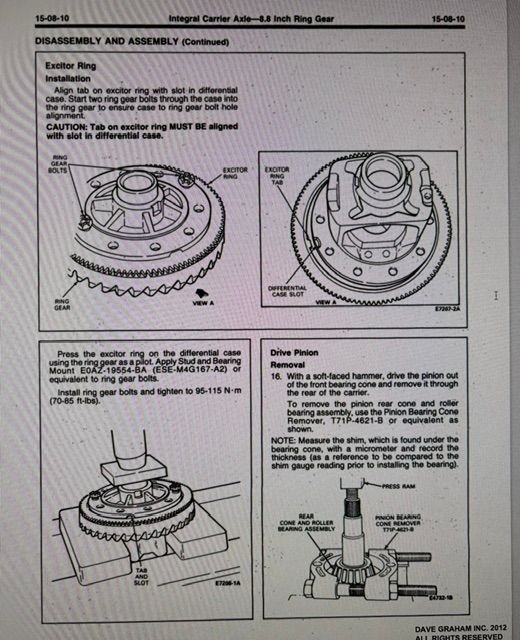

Finishing up the details on an 8.8. I picked up a new Ford tone ring, I was surprised to see it does not have an alignment tab.
Am I correct in thinking that the index of the ring does not matter so long as it correctly seated on the carrier?
The spacing to the sensor would vary depending on the shiming of the carrier so it must work within a range.
Thanks!

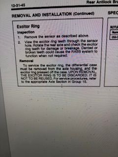

and section 15

Yes, yes. But does the lack of indexing tab matter? My understanding, seems like it doesn't but I have been wrong on occasion.

Must be important since it’s in bold print

Mine didn’t have a tab that I remember. Also didn’t know you’re not supposed to reuse them.. oh well!

I've never read or heard anything about not being able to swap them over to a new carrier
I will double check in a manual
Swap away, the ring gear bolts just hold it tight to the face of the carrier behind the ring with NO INDEXING TAB
That was taken from my 1989 Ford Service manual. What manual are you going to check?

The tone ring doesn't have to be indexed to any specific point on the carrier (unless the tab interferes with the carrier in a way that doesn't allow it to be seated in the correct position to be read by the speed sensor).
Stick it on and run it....the sensor doesn't read position, it just reads the frequency of "teeth" passing by it. I've built rear axles for many of these pickups that had/didn't have the tone ring that needed it. There are a couple running around the county with 2 or 3 tack welds holding them on the carrier and the indexing tab ground off.
