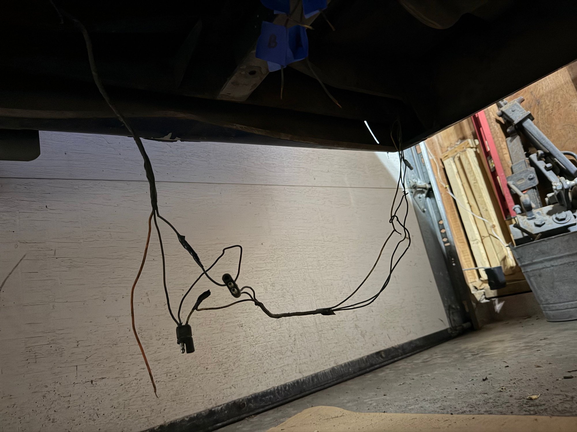

1969 F100. Previous owner had backed over something and dented the roll pan and tore the rear wiring harness apart. The wires leading to both driving lights/ brake lights/backup lights are still there, but the plug that those wires plugged into is gone. I found which wires are hot when the rear running lights are on, then when truck is put into reverse, and then when the brake pedal is depressed. Can I just splice all that together to the existing tail light harness to make them work for now? In the picture I marked the hot wires for the brakes with a "B" , the running lights with an "R", and the backup lights with a "BA". Any pointers on how to make it work?

Yes you can splice the wires to reconnect them. That's what was done to add trailer lights. I would recommending soldering the connections and seal up with some shrink tubing. These wires are under size so they will not carry a lot of current, besides the voltage drop. I would use 16 ga wire if you need to extend them.

Agree with blue. Should be pretty straightforward. In fact, you can even make it better if you are reasonably proficient at splicing and dicing, and have the tools.

Do you still have the connector on the tail lights?
You do need some way to disconnect the lights so the bed can be removed if needed.

Thanks for the advice and tips, I'm going to go buy some wire and connectors and give it a shot.
