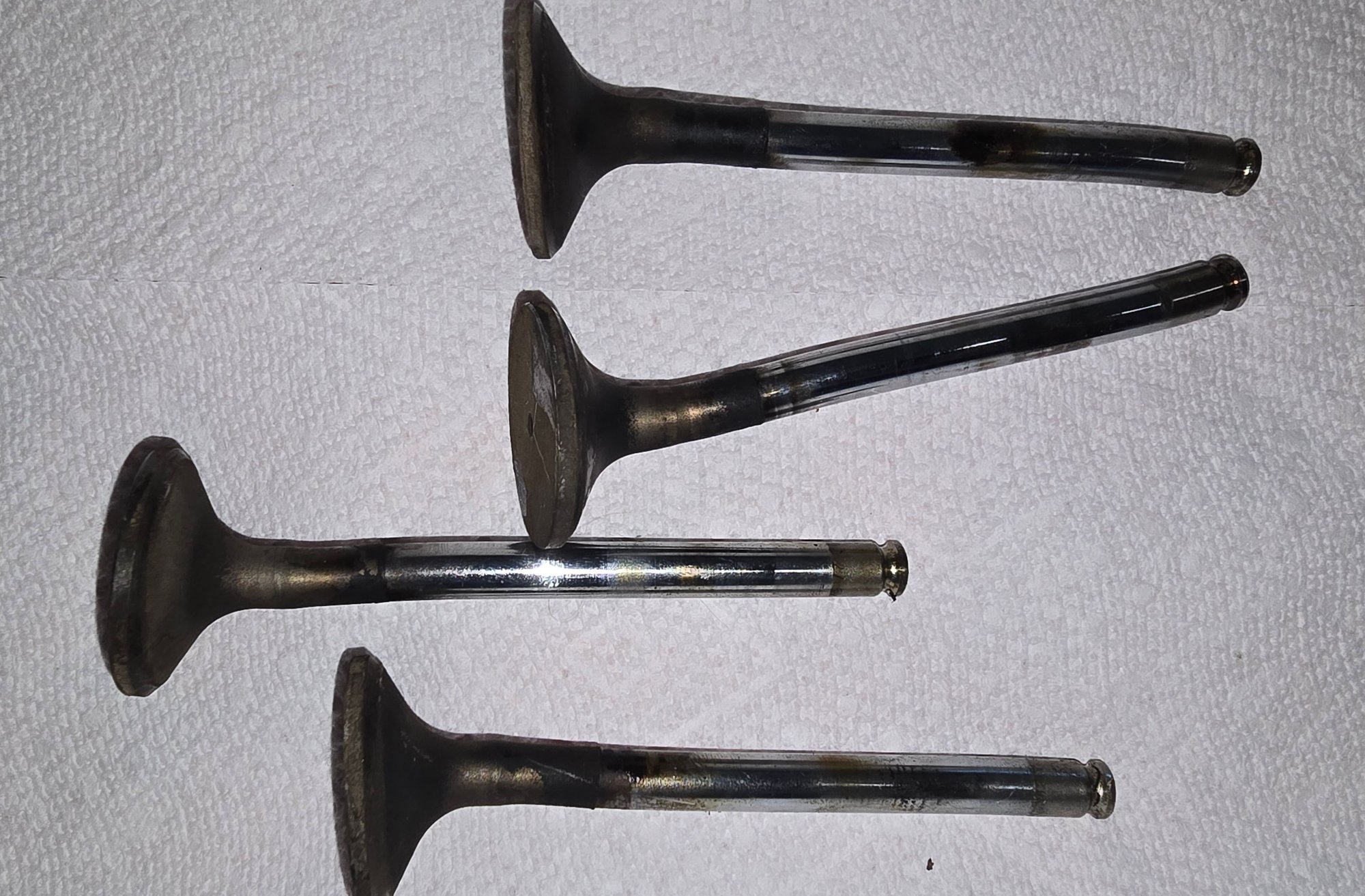

Either lift too high or wrong pistons to bend valves like that. Now it will and can happen if the timing jumped.

Look at these I took out of a 107 Mercedes 380SL
Happens to the best of them
