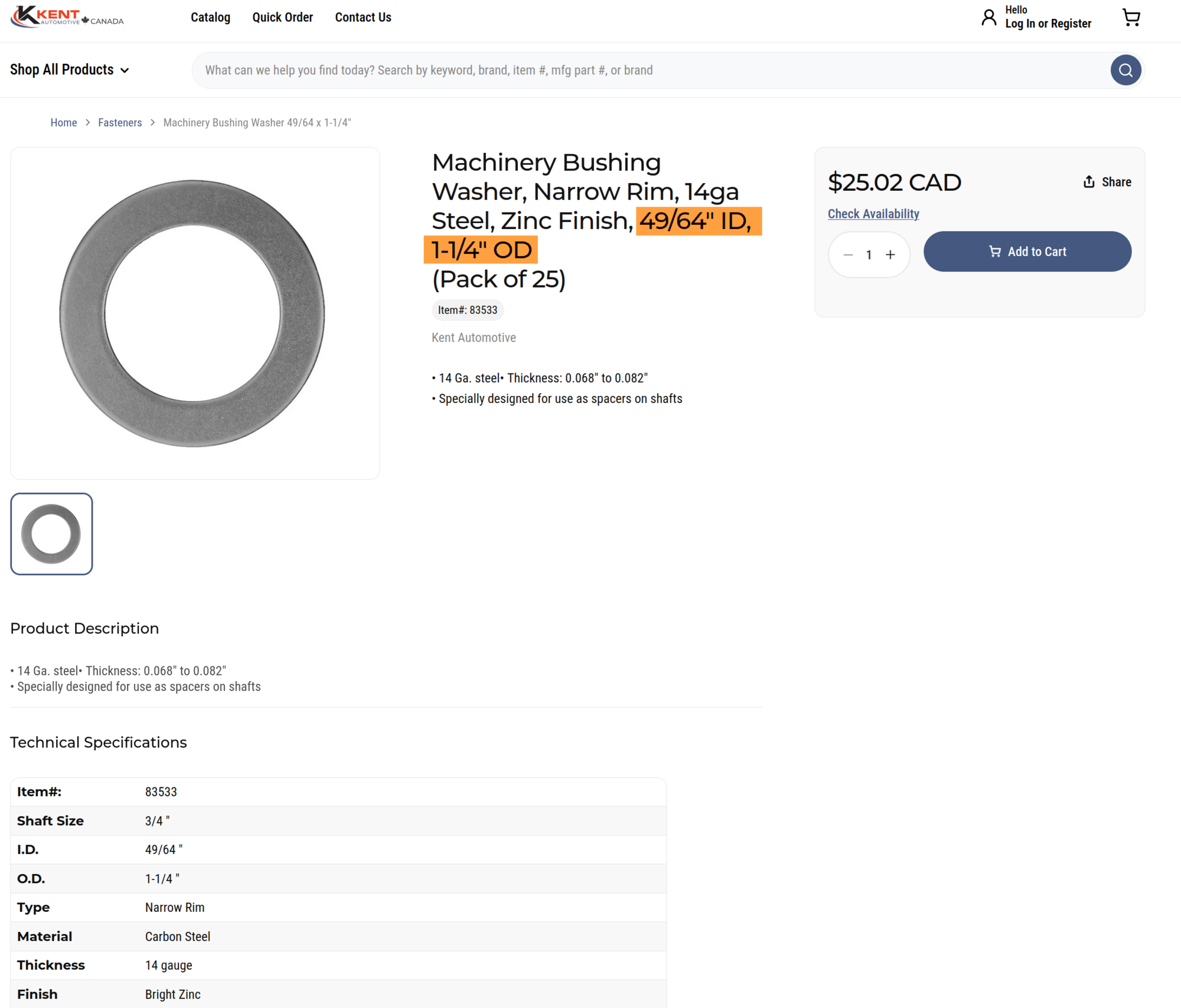

[later]
Group buy?
https://www.kent-automotive.com/en-c...46132524450012
That's not an awful price in USD, if the tariff (and esp. shipping) doesn't triple the cost.
Same part numbers for Y-blocks, so there ought to be some around.
