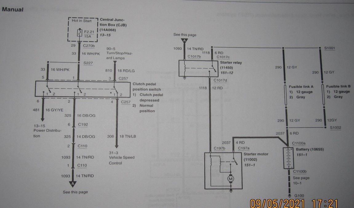

Here is the schematic for a 2003 manual transmission. The fuse is probably the same. Worth a quick check.

Originally Posted by BareBonesXL
Is it an automatic? You said neutral safety switch.
ya I check that fuse first thing yesterday morning.

A 2003 EVTM like Bare bones posted will have the schematic and a start circuit diagnosis page
A copy of that book would help you
