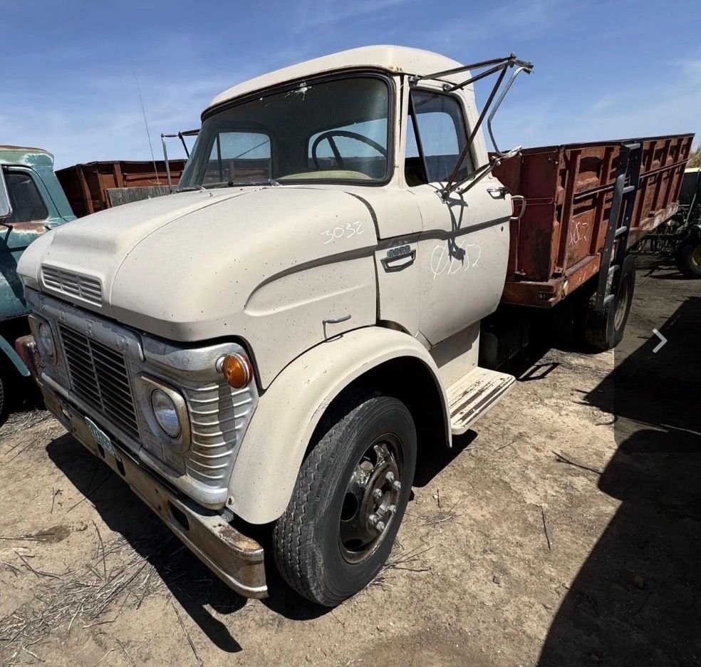

Hello, would anyone be able to help decode a VIN plate from a N600.
thanks in advance.

N60 = N600 gas
D = 330 2V HD FT gas V8
U = Louisville Assembly Plant
794572 = 1966 numerical series, probably December 1965 production. (Shop manual shows Dec '65 ending at 792,999 for Louisville Mediums, 801,999 for Heavy. The 600s were Mediums but I think they were counted with the Heavy numbers. Maybe.)
163 = 163 inch wheelbase
H = Light Beige
N600 = N600 gas, 17,000 lbs GVWR
KM81
K = Blue woven plastic and blue vinyl with foam cushion
M = Beige woven plastic and beige vinyl with foam cushion (IF your interior was two tone. Otherwise, forget the M it was Ford use only)
81 = Conventional cab, cab and chassis vehicle.
I don't have a breakdown on Regular vs. Custom Cab.
A = New Process model 435 four speed transmission
F8 = Eaton model 13802 two speed rear axle, 15,000 lbs capacity, 6.33 / 8.81 ratios.
No front axle code. In MY '64 to '69 only optional axles were listed. So, Ford axle, probably 4.500 to 5,000 lbs capacity, no power steering.
17000 = 17,000 lbs GVWR
164 3800 = 164 Certified Net HP @ 3800 RPM
53 = Kansas City District Sales Office
No special order.
