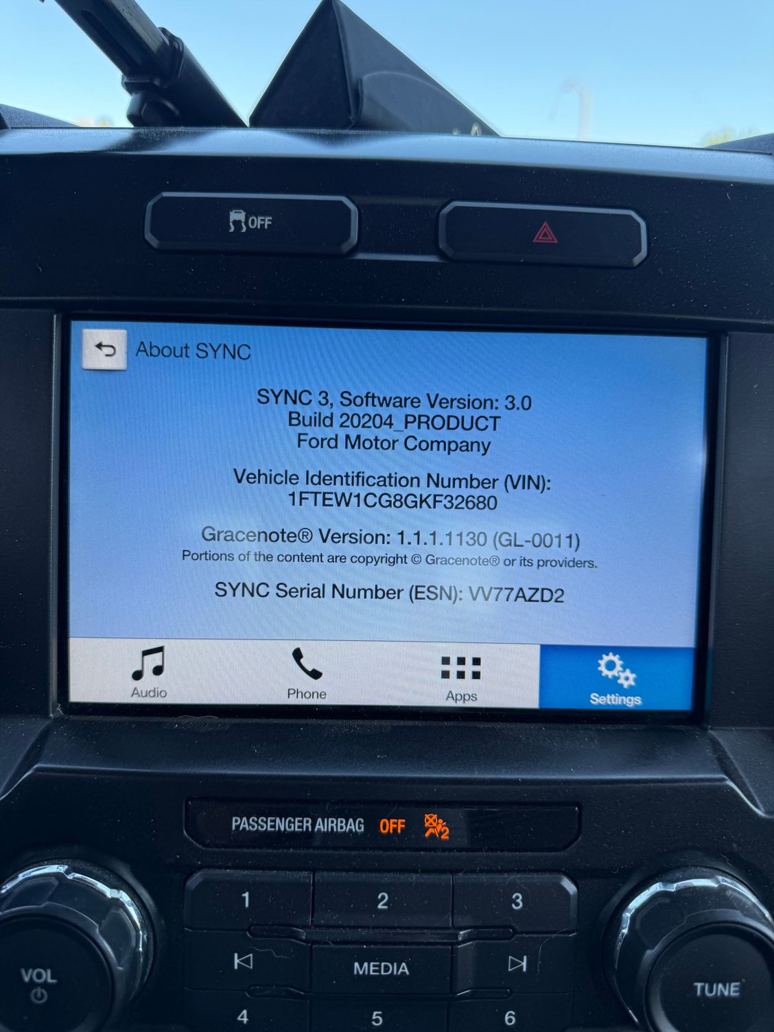

Hey! New to forums here. I’m looking for help with Sync3. Everything I read online Apple CarPlay and apps should work on mine, but it never has. What am I missing or not understanding?

Hope I am replying correctly. Technically I am not having any issues as far as I can tell. There are options to find apps and such on the screen but nothing has ever popped up. Phone and music work fine through Bluetooth and USB but I keep reading on line that “SYNC3” should support car play and such. I guess I should have been more inquisitive when it was still under warranty.

You likely need an actual apple cord, plugged into one of the USB ports on the dash. If you bought the truck used, see how many other devices are sync'd to it, and delete them. You can also do the same to yours, then re sync it.

It wont work via Bluetooth, as far as I know. You need to have it tethered via a USB port.

This is right it has to be tethered with a USB cable or buy a adapter to make it wireless.

When I bought my 2016 they had to change the hub that the cable plugs into to get Android Auto to work.

When connected with a cord, does Google maps work? Not all apps work on the screen, it depends on the app and it's design. (actually very few do)
