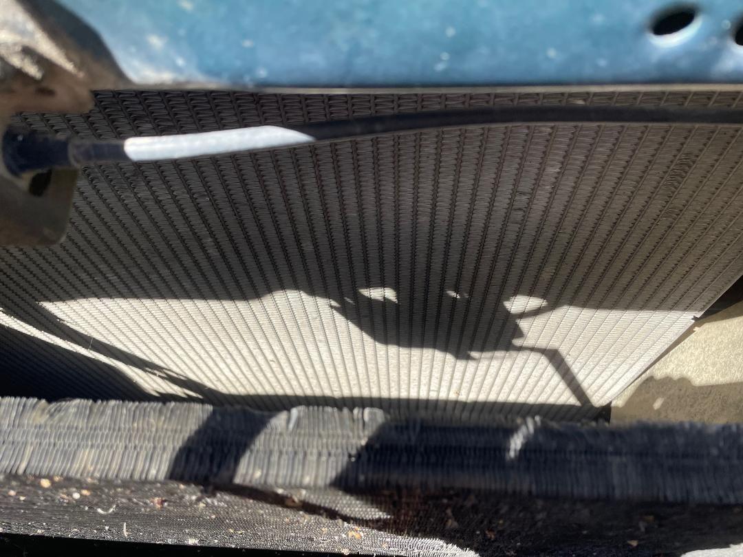

Could you post a picture of the front of the radiator?

Would be hard to get a photo of the front of the radiator since it's still in the truck.

Old May 11, 2026 | 02:33 PM
  #30
LX Sport's Avatar
LX Sport
Joined: Oct 2009
Posts: 46
From: Colorado Springs, Co
Well, that's not the problem.
