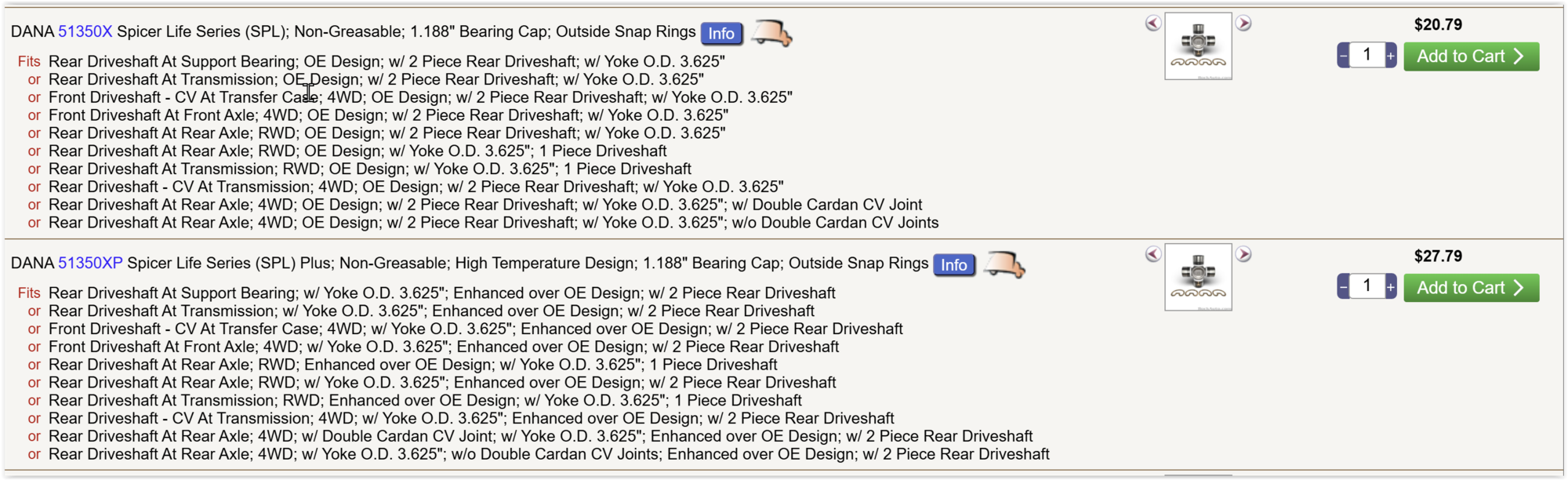

Need to figure out which DANA Spicer non-greaseable are appropriate for my truck. Multiple sizes on RockAuto.
FYI I greased my front wheel u joints the other day!! So proud.

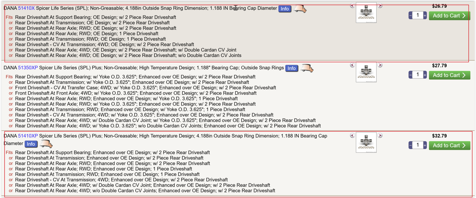

Your front axle u-joints also started life as non greaseable units and will suffer the same fate if overgreased. If grease squishes out from under the cap, it's going to like constant attention.
If you have three single cardan joints, they will be 1410s. If you have a double cardan joint, it will contain 1350 u-joints in that unit and 1410s in the other positions. I recommend letting a professional shop do it if the double cardan joint needs u-joints.

I have 3 singles on my 2 piece rear driveshaft. The front driveshaft is double cardan joint me thinks.
Looks like RockAuto has two 1410 options:
Are these 1350's correct for the front?
