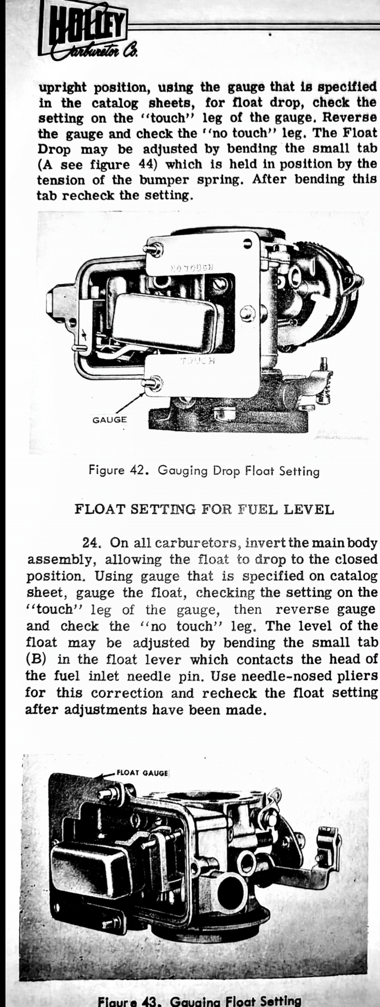

As for float height adjustment, you can use a float gauge like this MC-157 to set the float drop and float height per the Holley 1904 manuals: https://www.ebay.com/itm/186781434554
Or you can focus on the float height by inverting the carburetor and measuring 13/64 from the inside of the bowl to the tip of the float (farthest form the fulcrum).

I did buy the float bowl tool off of eBay and got it yesterday. I will try that adjustment when I catch a break if adjusting the mixture screw doesn't do it. I am loathe to take the carb off if I don't have to.
