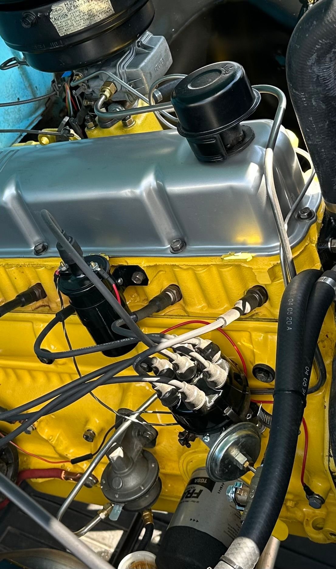

I know you have a 6 cylinder so I'm not sure how you fuel line runs to the carb. But I did a trick that pintoplumber taught me. He and then I put a rubber fuel hose over my hard line where it is close to the block and the crossover exhaust pipe. I haven't had vapor lock occur since then.
But you haven't been driving in 90° weather this spring. So it might not be vapor lock.

If one really suspects "heat soaking" being the issue, there are those who believe in phenolic spacers like this:
https://www.ebay.com/itm/236779161817
https://www.ebay.com/itm/267653674076
You can also be sure your fuel lines are routed away form heat sources like exhaust.

The fuel lines run in the stock location. From the pump up along the front of the block, cross over the front of the valve cover and due the valve cover to the carb. Pic below.
I eliminated the points and am running a Petronix electronic module in the distributor.
How would I know if it is leaking down fuel into the intake? When I get it fired up again I will try adjusting the mixture screw as I suppose it could be out of adjustment as the engine and everything has been broken in.
I think I have some fuel line insulation left over from my Camaro and can try putting that around the lines. The trick is finding it!
