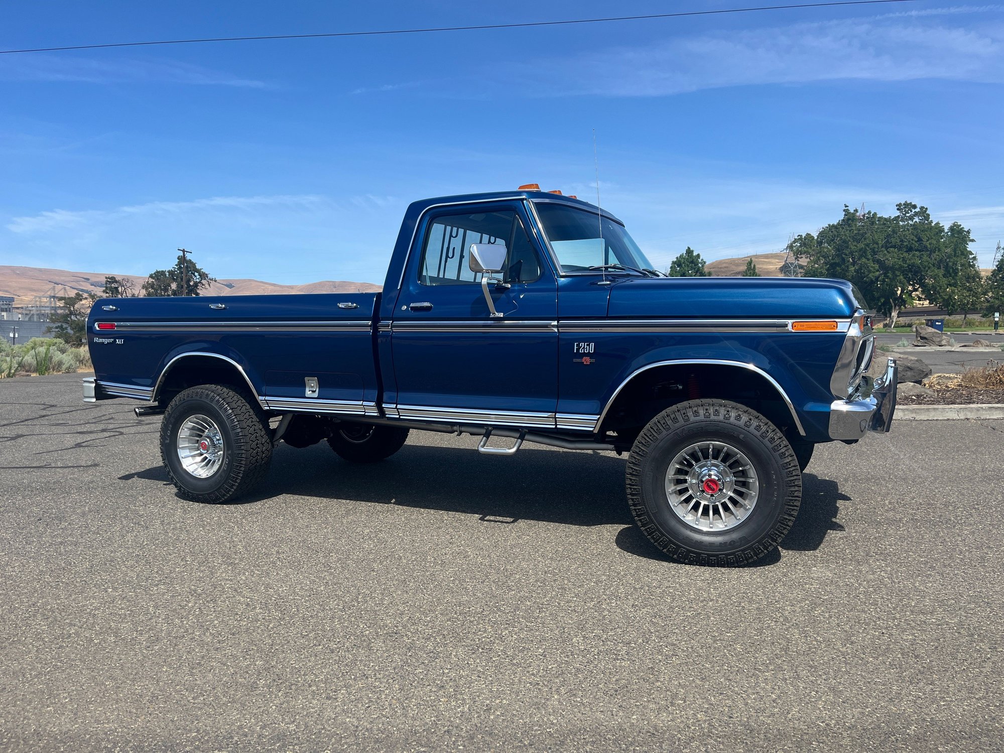

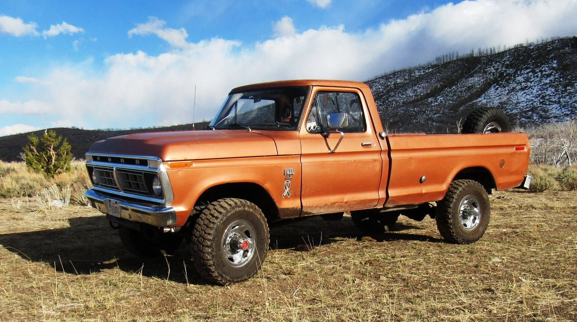

I have a 76 SCS. I'm running these slotted aluminum wheels in a 17x9. Don't know the offset cuz I don't remember.

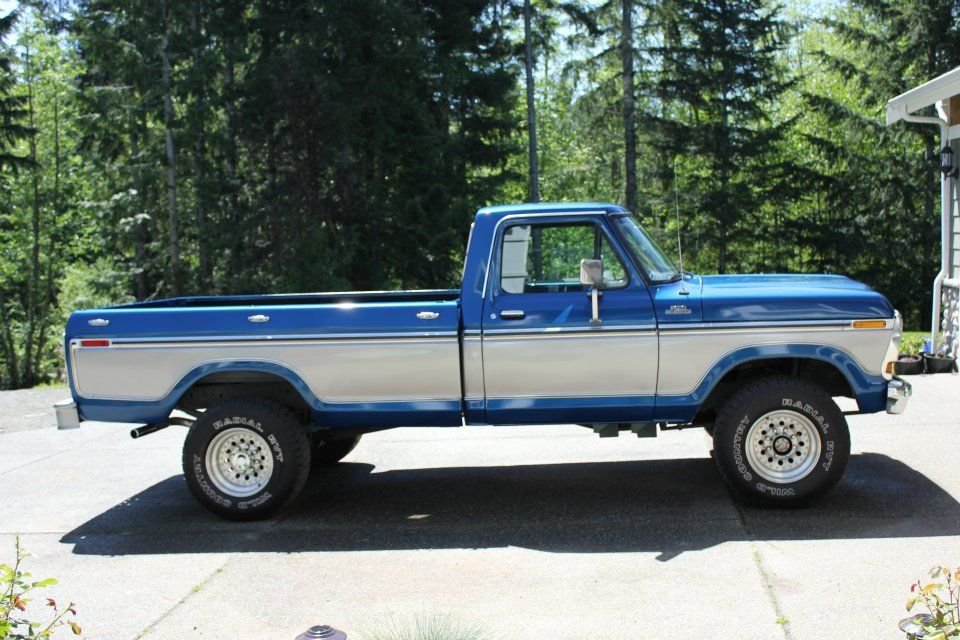

I prefer vintage correct wheels since I'm old enough to remember what's correct. the biggest drawback to them is most of the 8 lugs of that era are 16.6 and he tire selection poor at best. an easy and cheap way to go are the white or chrome mojocks, or wagon wheels they call them now. vintage correct and in 16".
These are my Western Turbine's date stamped 1979.
