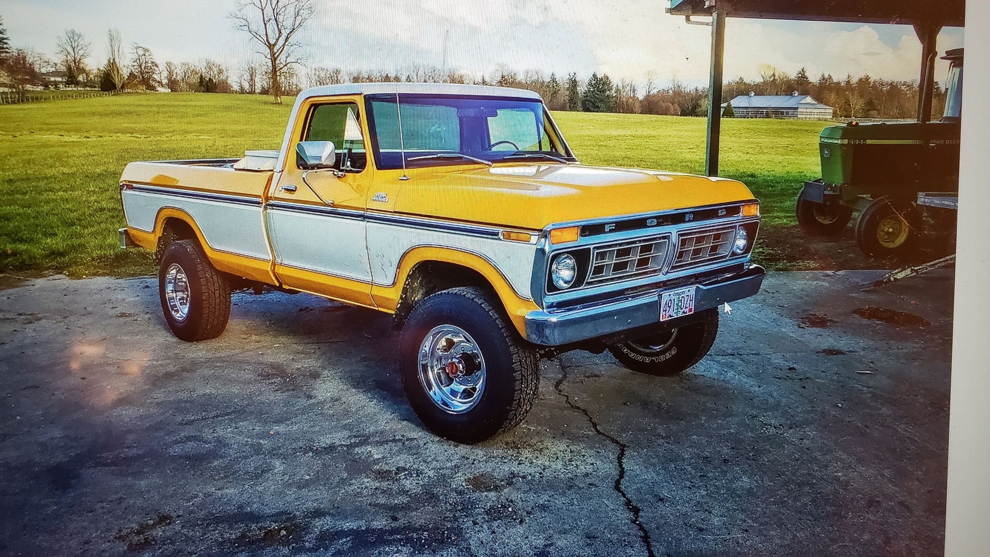

This would be what i would go with or the Mickey Thompson version
U.S. Mags Indy U101 Polished Wheels 17x10
Not my truck stole pic off the internet

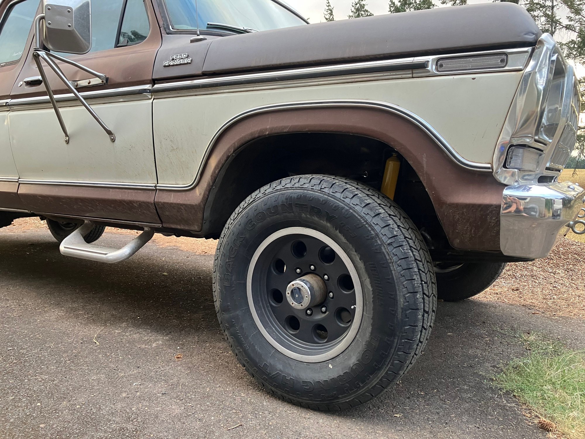

I swapped a guy my 16” x 10” aluminum mags for older 17” x 8” American racing wheels. I specifically wanted 17s to be able to run the same tires as most modern 3/4 and 1 ton trucks.
Especially with something wider, your backspacing is critical. Make sure you understand everything about wheel fitment and attachment before spending a single dollar.
32.5” OD 10 ply sidewall Dean Tires (cooper) “backroad” highway tire. Factory style 2 leaf under 1978 f250 4x4 Dana 60, with a helper to level it out. Good clearance around the disc brakes, and plenty of clearance when turning. No the sexiest looking tire for a 4x4 but very functional for a 3/4-1ton.
