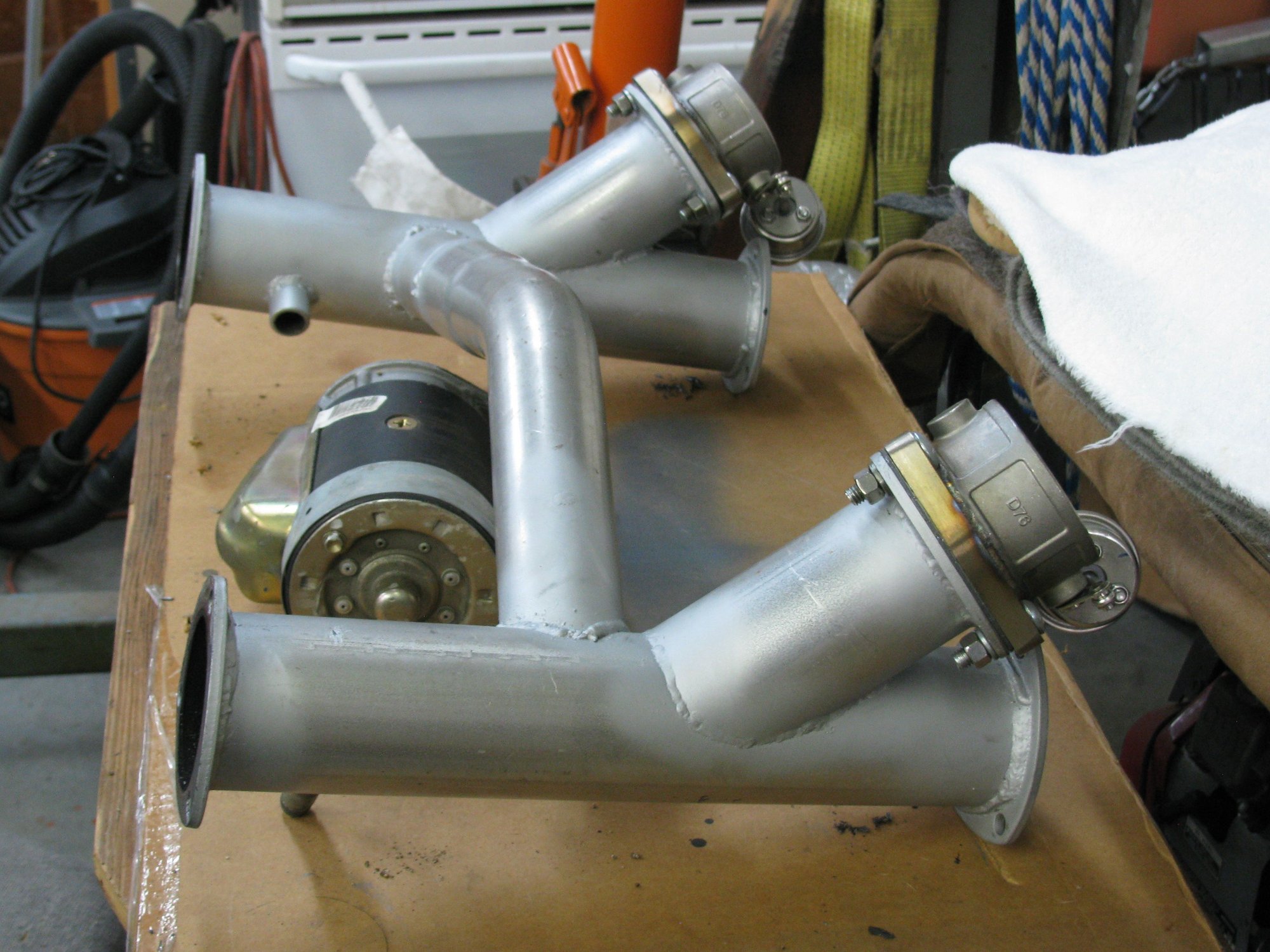

40's weren't loud enough I have 40's with 2 1/4 pipes and they are a bit too loud. I also have 3-inch vacuum operated exhaust cutouts for when I do want to be loud with no back pressure.
Here in the Arizona high desert the sound just carries differently. Lots of open space. More dirt, less concrete. Have been thinking about adding cutouts : )

Engine Masters did a show on exhaust cutouts, surprisingly they recouped almost all of the horsepower that was lost with a full exhaust and mufflers. I always thought they were for more noise. I put mine together with parts and pieces off of e-bay. The vacuum type is instant on or off, but you do have to have a vacuum reserve tank with a check valve to keep them from closing at wide open throttle.
