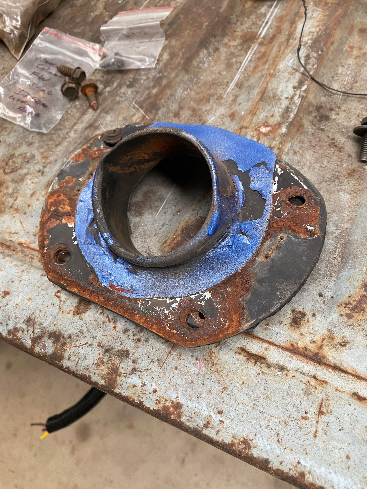

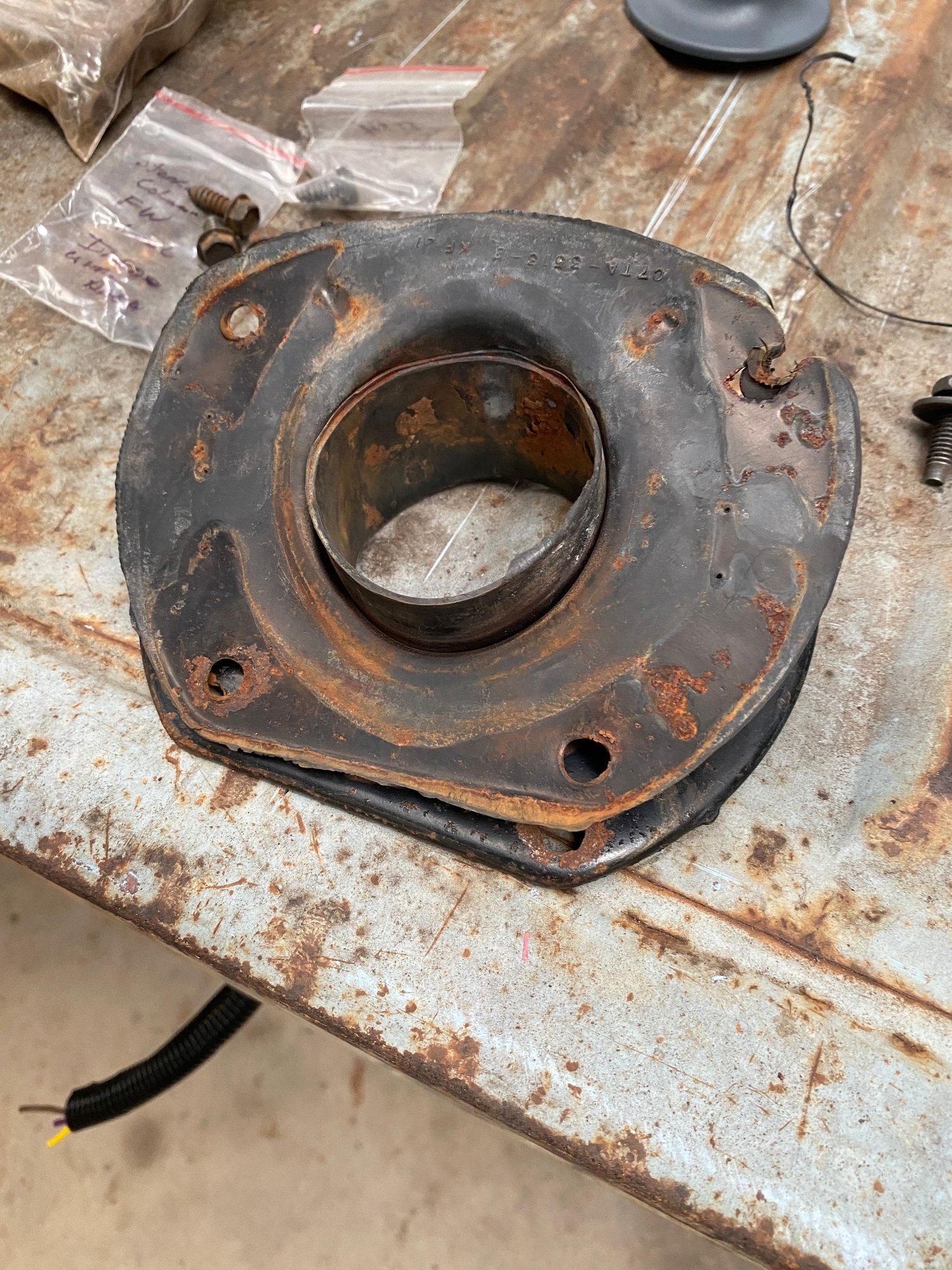

I was going through my parts looking for items I need to media blast and clean up and run across this steering column seal.
I noticed that the lip was turned in which I thought was odd. Did Ford do this on purpose to improve the seal?
Seal turned in
Seal turned in
Steering column seal
My Ididit column is 2" od not the 2 1/4 as the original one. So turning this in would make a tighter seal.

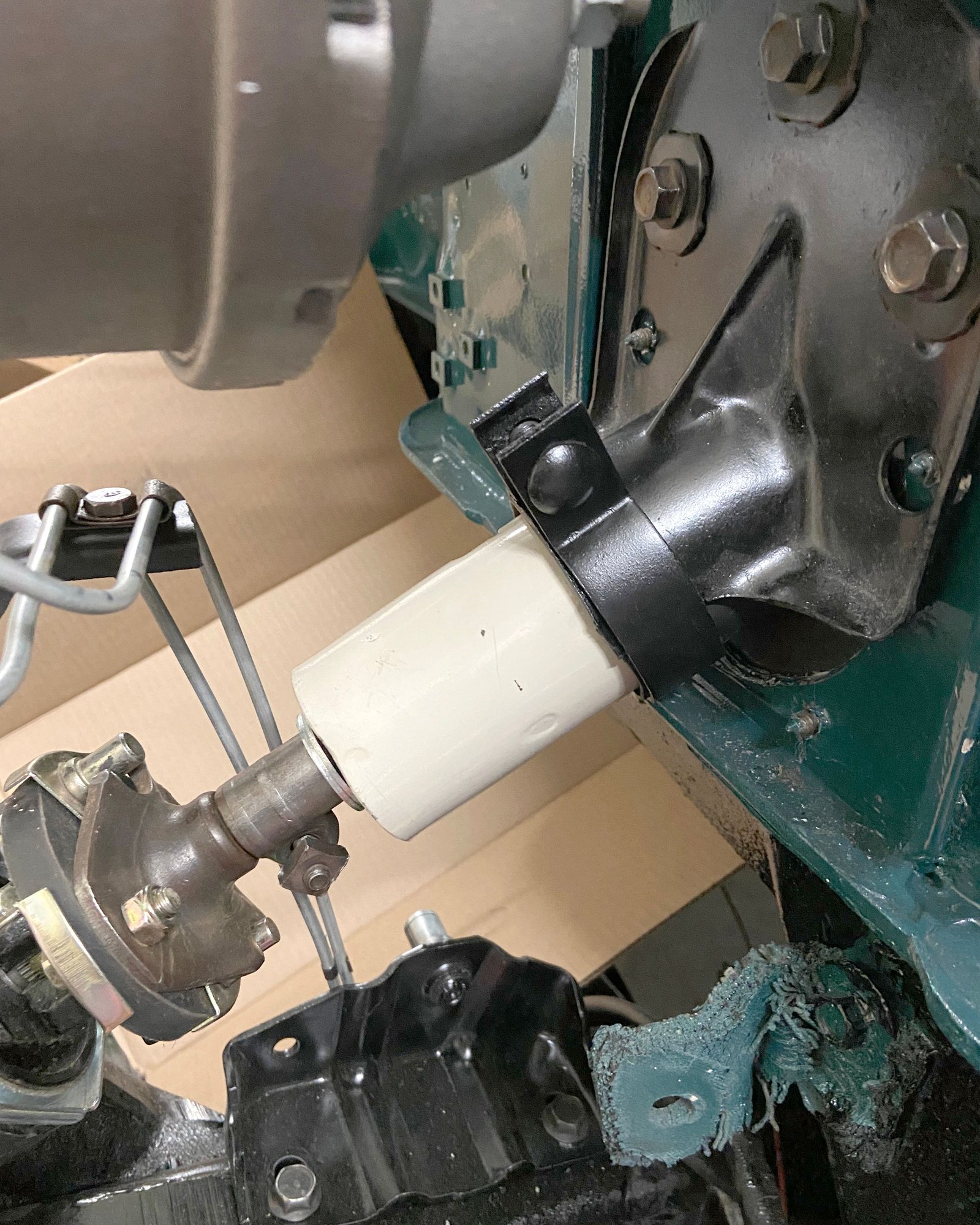

My '68 F250 doesn't look that way. On mine the rubber seal is under the steel flange - might be with yours also. the seal extends as far as the flange and is secured with a hose type clamp.

Yes. That's the way mine was but the tube was turned inside to increase the pressure on the tube. 1st photo. Which I was though to be a little odd.
