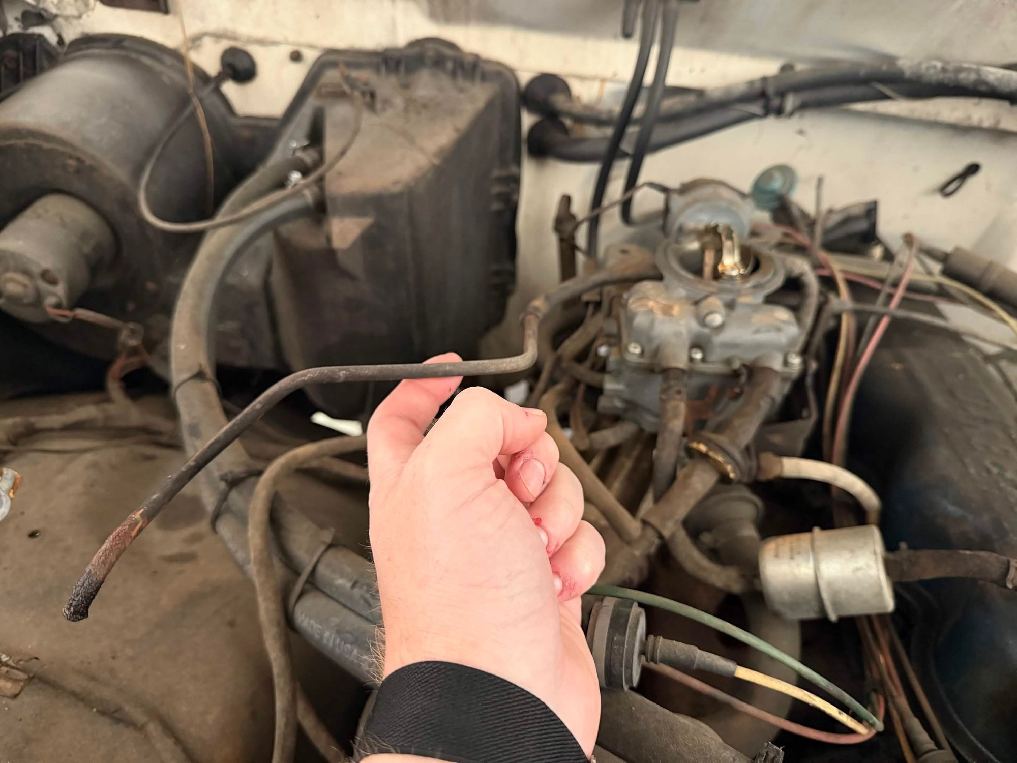

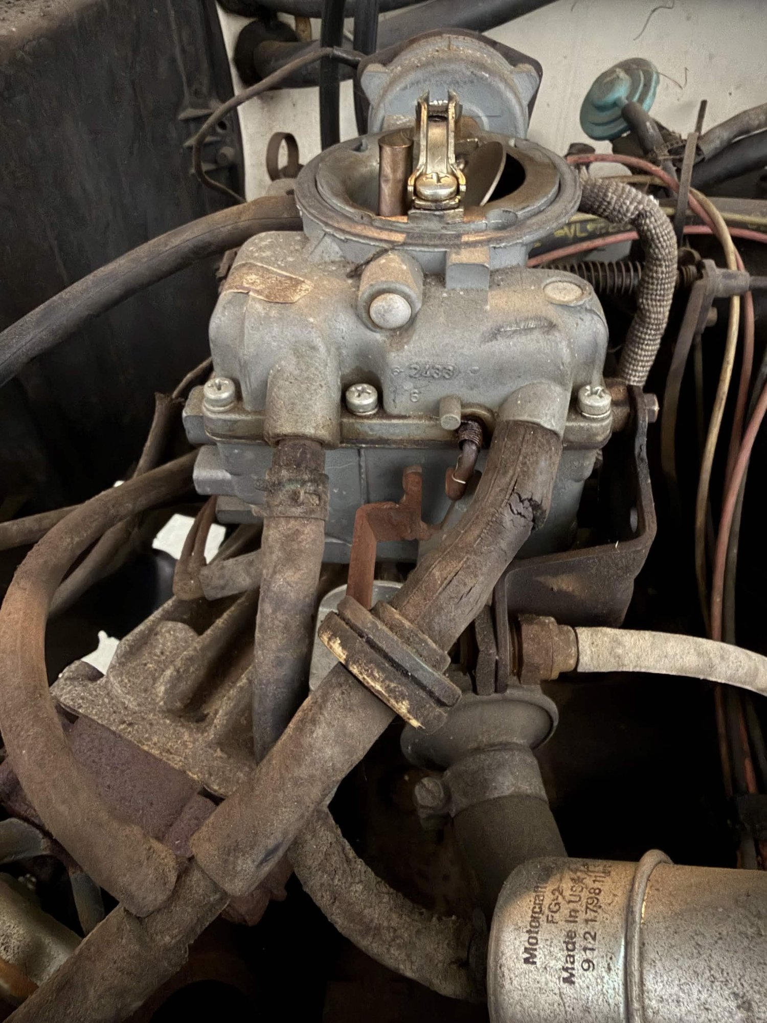

Here are the two hoses in question (pictures taken from front bumper). One is a hard line coming out of the "passenger" side of the carb and the other is a soft line coming out of the front. No idea where the hard line goes (when i was putting my hands on all the hoses to check for damage, this one was already clean off), but the soft line with a hole in it goes to a tank mounted on the passenger side front wheel well in the engine bay. I assume this is a dual fuel tank configuration because that tank has another line leaving it going out the engine bay at the bottom and follows the driveshaft to the rear of the vehicle (going to trace that line tomorrow).

Ok this metal line goes from carb as you can see to the exhaust manifold. This is the clean air side of the hot air asst. choke.
It is common that the hard line rust off like that.
Dorman makes a repair kit for this not remember the part number ATM. It pots a fitting in the exhaust manifold to put a hose on. Vacuum hose will work for this.
For now you can just remove the metal line so it does not get in the way and deal with this later if you want.
This hose in part of the vapor recovery system, It gathers the gas fumes from the tank(s) and the carb float bowl and traps it in a charcoal canister under the battery and when the time is right a valve opens and the vapor is pulled into the motor and burned. The factory used some kind of vacuum hose but I would get gas hose up near the carb to replace that cracked one.
Just be careful of that Tee and that 1 way valve between carb and Tee as you cannot get them and that Tee has 2 different size hoses on it so it is hard to make too.
Just to the left of the 1 way valve is the rubber fuel hose in 5/16" size and should be replaced because of age. If you follow that hose back it will go to the fuel pump.
There will be a rubber hose on the inlet side of the pump that should be changed. And if you follow it back to the tank(s) there will be more rubber hose that should be changed out.

That's 4 hours away from me. By the way that round silver can thing in the lower part of the picture is the fuel filter.
