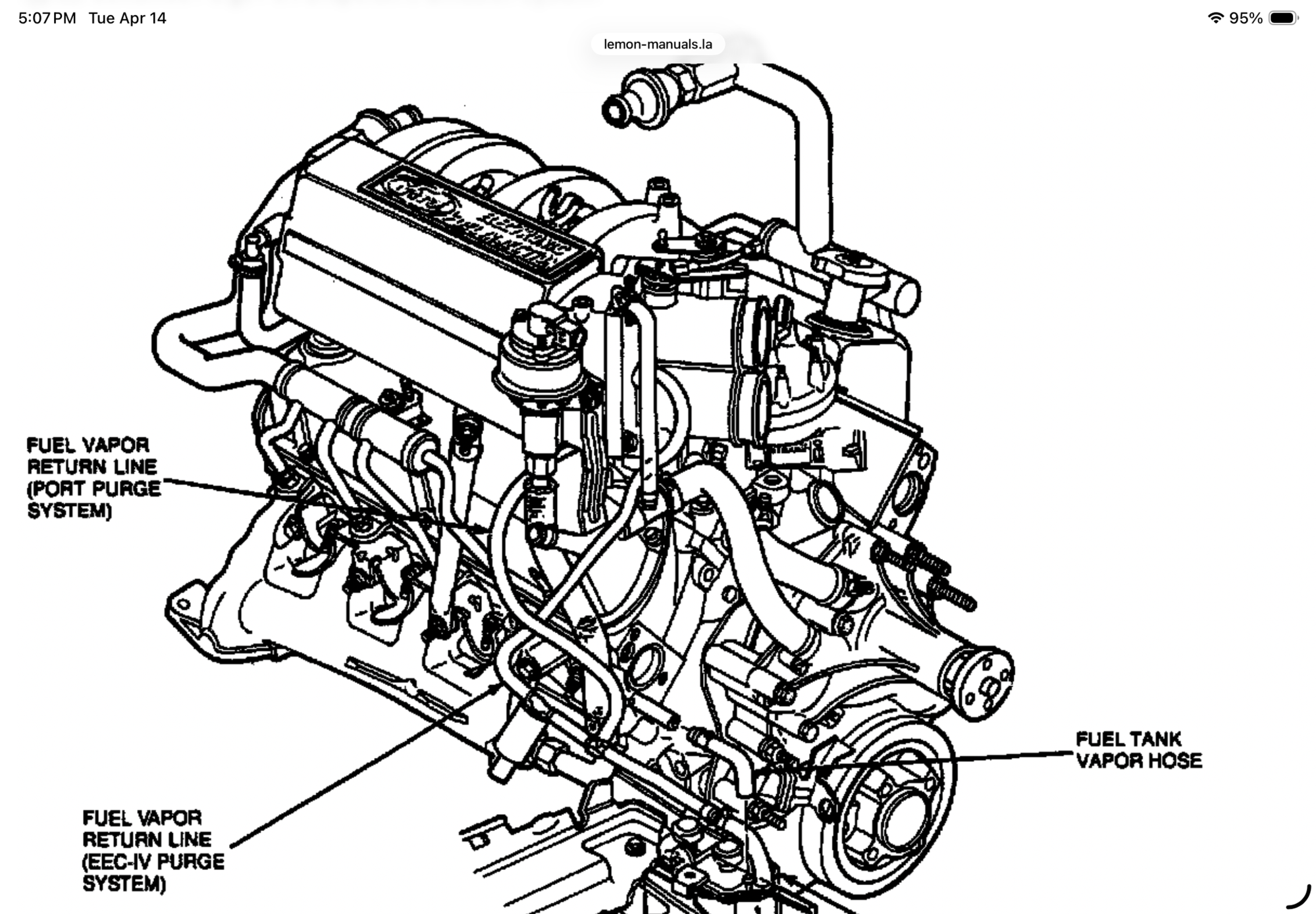

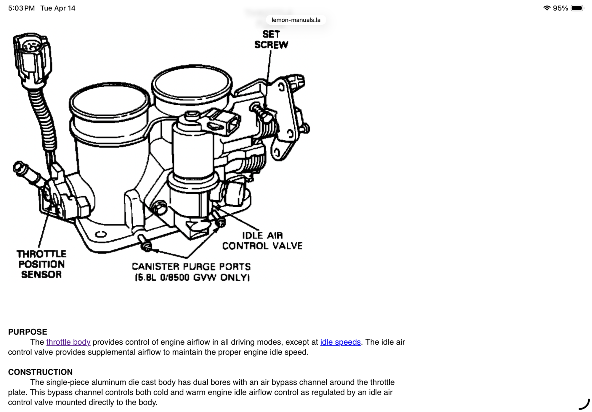

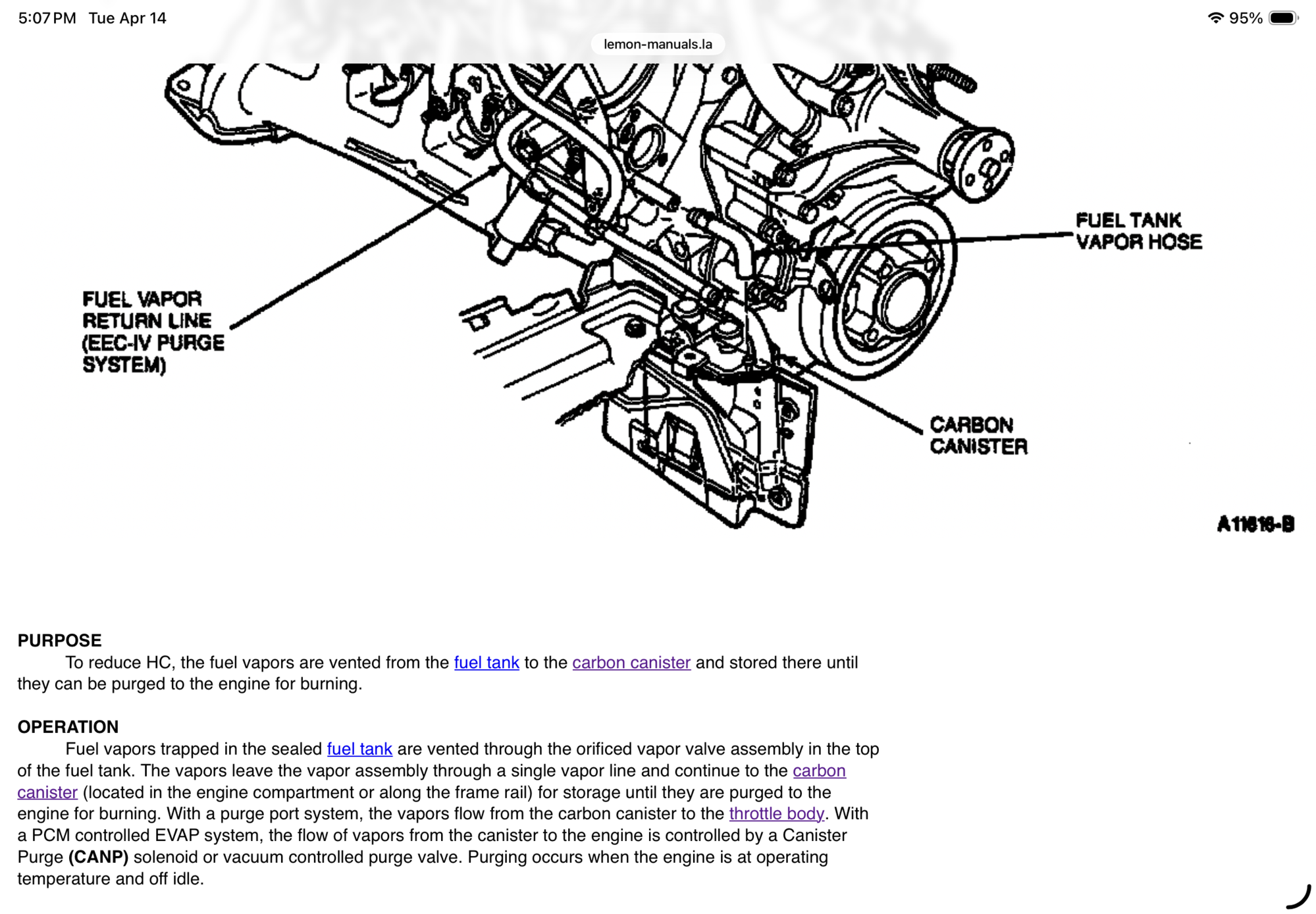

Greetings all,
94 E350 Club Wagon 5.8L
Need a little help identifying a throttle body to fuel vapor canister line. Part in question has to do with two 1/4" studs mounted on the left (driver side) valve cover. The only reference I have found shows the 2 1/4" hoses coming off the throttle body to a "T" fitting that has another 1/4" hose that goes over the valve cover to something that attaches to the two studs and continues to the rear of the engine where it goes into a 5/8" hose that connects to the vapor canister.
Any ideas?
Thx

This is what I have
