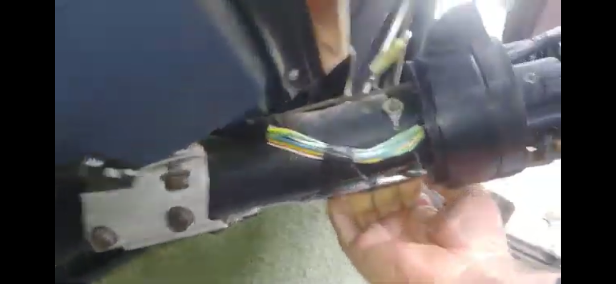

That is where the light bulb is on my 88 E250
Here is a screenshot of the light bulb:
it came from this YouTube video. It is long, but the old man will eventually get to it.
