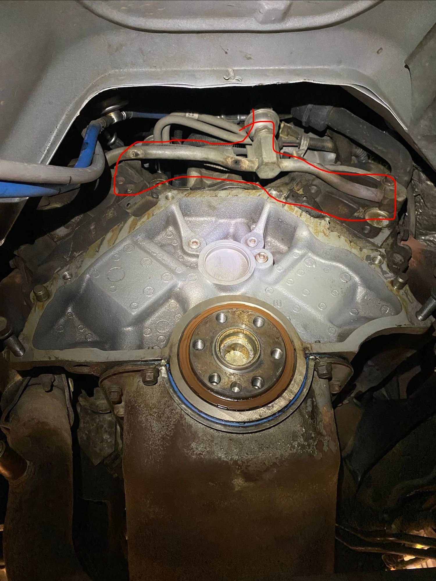

Can anyone tell me what this tube is called?
the one with the holes. This is on the back side of a 1995 F250 with a 351w.

Air injection manifold. Smog pump pumps into it and it connects to the cylinder head which distributes the air to the exhaust.

It is part of the Thermactor system, if looking for the technical name.

Standard Motor Products AT129

yeah, mine did that, too.
And of course, the ends are rusted solidly into the head.
It's not much fun to get to, is it?
