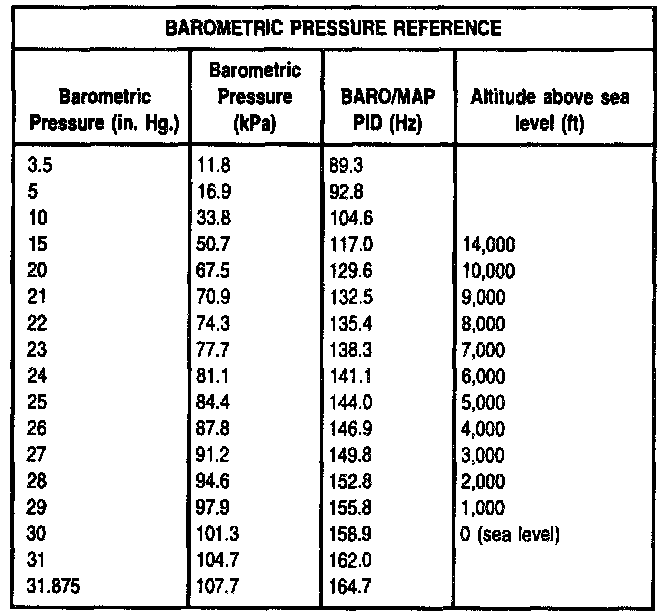

NOTE: DO NOT DISCONNECT THE BATTERY. IT WILL ERASE KEEP ALIVE MEMORY AND RESET LONG TERM FUEL TRIM AND BARO TO THEIR STARTING/BASE VALUES. THE BARO PARAMETER IDENTIFICATION DISPLAY (PID) IS USED FOR THIS DIAGNOSTIC PROCEDURE. ALL OBDII APPLICATIONS HAVE THIS PID AVAILABLE. THERE ARE SOME OBDI VEHICLES THAT DO NOT HAVE THE BARO PID, FOR THESE VEHICLES OMIT THE BARO CHECK AND REFER ONLY TO STEPS 2, 3, AND 4 IN THE DIAGNOSTIC PROCEDURE. 1.Look at the BARO PID. Refer to the Barometric Pressure Reference Chart in this article. At sea level, BARO should read about 159 Hz (29.91 in. Hg). As a reference, Denver, Colorado at 1524 meters (5000 ft.) altitude should be about 144 Hz (24.88 in.Hg). Normal learned BARO variability is up to +/- 6 Hz (+/- 2 in. Hg.). If BARO indicates a higher altitude than you are not at (7 or more Hz lower than expected), you may have MAF contamination. If available, Service Bay Diagnostic System (SBDS) has a Manifold Absolute Pressure (MAP) sensor that can be used as a barometric pressure reference. Use "MAP/BARO" test under "Powertrain," "Testers and Meters." Ignore the hookup screen. Connect GP2 to the reference MAP on the following screen.

2.On a fully warmed up engine, look at Long Term Fuel Trim at idle, in Neutral, A/C off, (LONGFT1 and/or LONGFT2 PIDs). If it is more negative than -12%, the fuel system has learned lean corrections which may be due to the MAF sensor over-estimating air flow at idle. Note that both Banks 1 and 2 will exhibit negative corrections for 2-bank system. If only one bank of a 2-bank system has negative corrections, the MAF sensor is probably not contaminated.
3.On a fully warmed up engine, look at MAF voltage at idle, in Neutral, A/C off (MAF V PID). If it's 30% greater than the nominal MAF V voltage listed in the Powertrain Control/Emissions Diagnosis (PC/ED) Diagnostic Value Reference Charts for your vehicle, or greater than 1.1 volts as a rough guide, the MAF sensor is over-estimating air flow at idle.
4.If at least tow of the previous three steps are true, proceed to disconnect the MAF sensor connector. This puts the vehicle into Failure Mode and Effects Management (FMEM). In FMEM mode, air flow is inferred by using rpm and throttle position instead of reading the MAF sensor. (In addition, the BARO value is reset to a base/unlearned value.) If the lean driveability symptoms go away, the MAF sensor is probably contaminated and should be replaced. If the lean driveability symptoms do not go away, go to the PC/ED Service Manual for the appropriate diagnostics.
