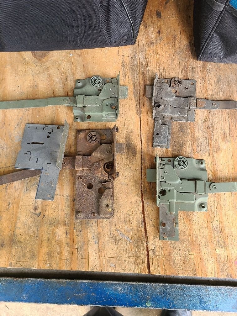

Has anyone thought of welding an attachment to the bottom. Most of the parts from the Passenger door lock can be used. will need to also create a cover/cap for the locking components. I do have a AutoCad dwg that I created years ago for the Drivers side door lock, just need to find it.
The one that is a folded piece of metal is what I started to work with years ago. The bottom left rusty one came from a 1940 Ford passenger car.
