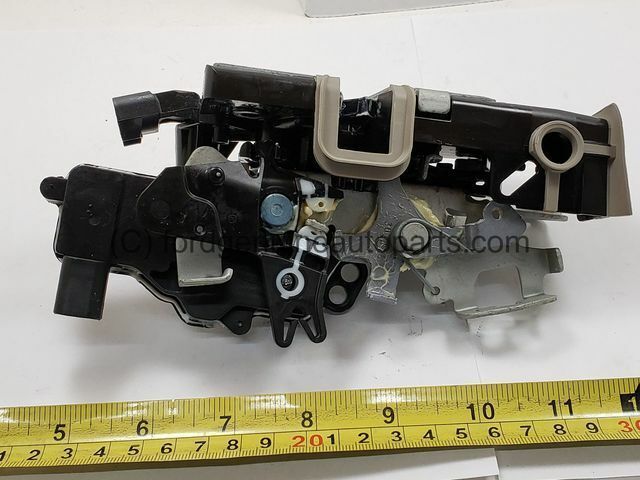

I used the VIN and come up with JL3Z1521812D which is listed as the actuator and latch at a price of $104.40. I'm still convinced the actuator can be sourced separate from the latch. Has anyone found it as a solo piece?
The part shown below is the exact part (6L2Z78218A) I have in hand from the local Ford dealer. It is definitely just an actuator and appears to be the same actuator on the actuator/latch shown above. I only see applications through 2010 so question if it fits my truck. I hate to pull the door apart only to find the part is wrong.
6L2Z-78218
When I use my VIN (2019) it comes up with an actuator with lock and also just an actuator, like shown in the last photo. Just the actuator is only $10.98. I would think the same options would be available for your year.

First off, I missed a part number mistake. I received P/N 6L2Z78218A43B from Ford parts. 4wd6.7L listed the correct P/N, 6L2Z78218A42B, for the right 2017 actuator but I assumed the 3 vs 2 difference was a revision change as most part websites only showed the P/N as 6L2Z78218A. My bad! Back to Ford parts who luckily had the right actuator on the shelf.
Secondly, when I dug into the door the second time with the correct actuator in hand, I found that my late 2020 build actuator had a plastic shield over it that prevented the "depress latch and slide" maneuver to remove it. It appears that much more disassembly would be required. I reassembled the door to regroup. From what I can tell, Ford still used the same actuator, but designed a shield to prevent the icing that program 20M04 addresses.
2020 front right door lock actuator. Black shield on left. Latch on backside. Actuator lever on right.
