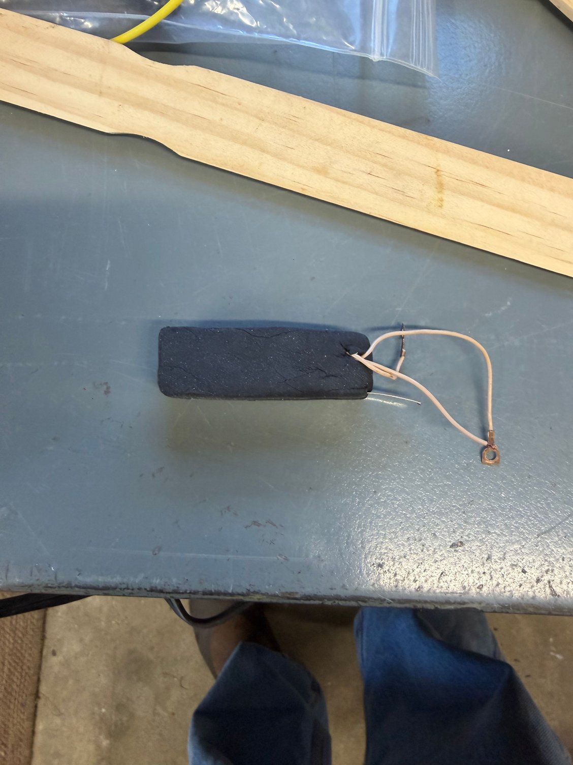

This may be a bit off topic but I wanted a tilt switch for lights under the hood on my Camaro. The stuff I could find online all had mixed reviews. The stock light socket is an old mercury switch so I got to thinking.....
I had an old mercury bulb thermostat lying around so decided to pull it out of the thermostat carefully! I had some foam "clay" that I am using for another part of my project.
First I tested the bulb as a tilt switch on a 12v light and it worked great. I cut the wire spring off but left a tab for a connector.

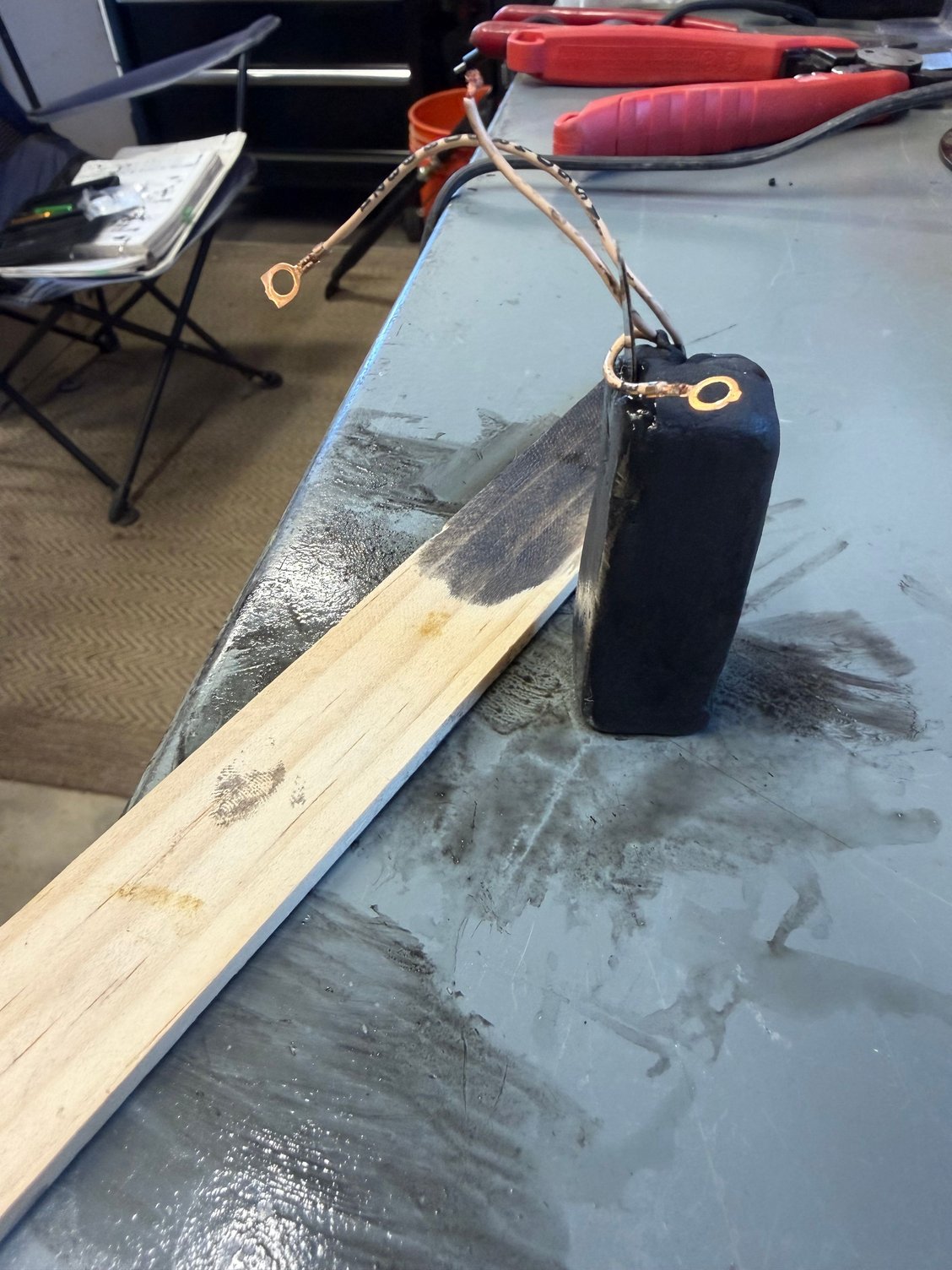

I wrapped the bulb in clay and shaped it with a paint stick dipped in water and stood it on end. The foam clay is to protect it from breaking and I am confident I could drop it from 10ft without it getting damage. However, it is not crust proof.

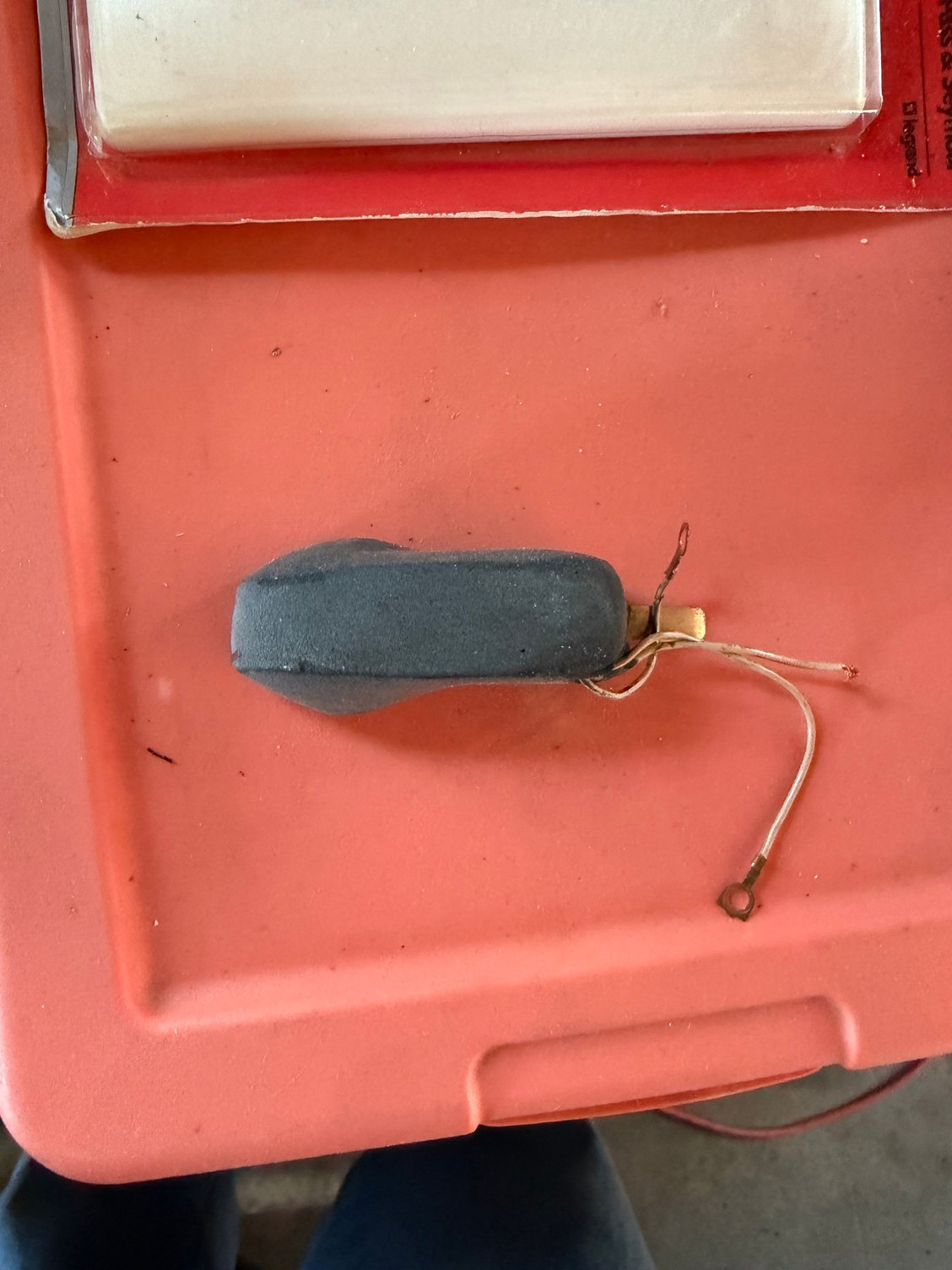

I left it out overnight to dry and when I came back it had fallen over. But sometimes you get lucky with a mistake. All of the uneven parts smoothed out and it took a shape that will be easy to mount. The bottom is perfectly flat and it looks almost like a factory piece.
so if you ever need a tilt switch and have an old thermostat I think this is probably a good solution.
