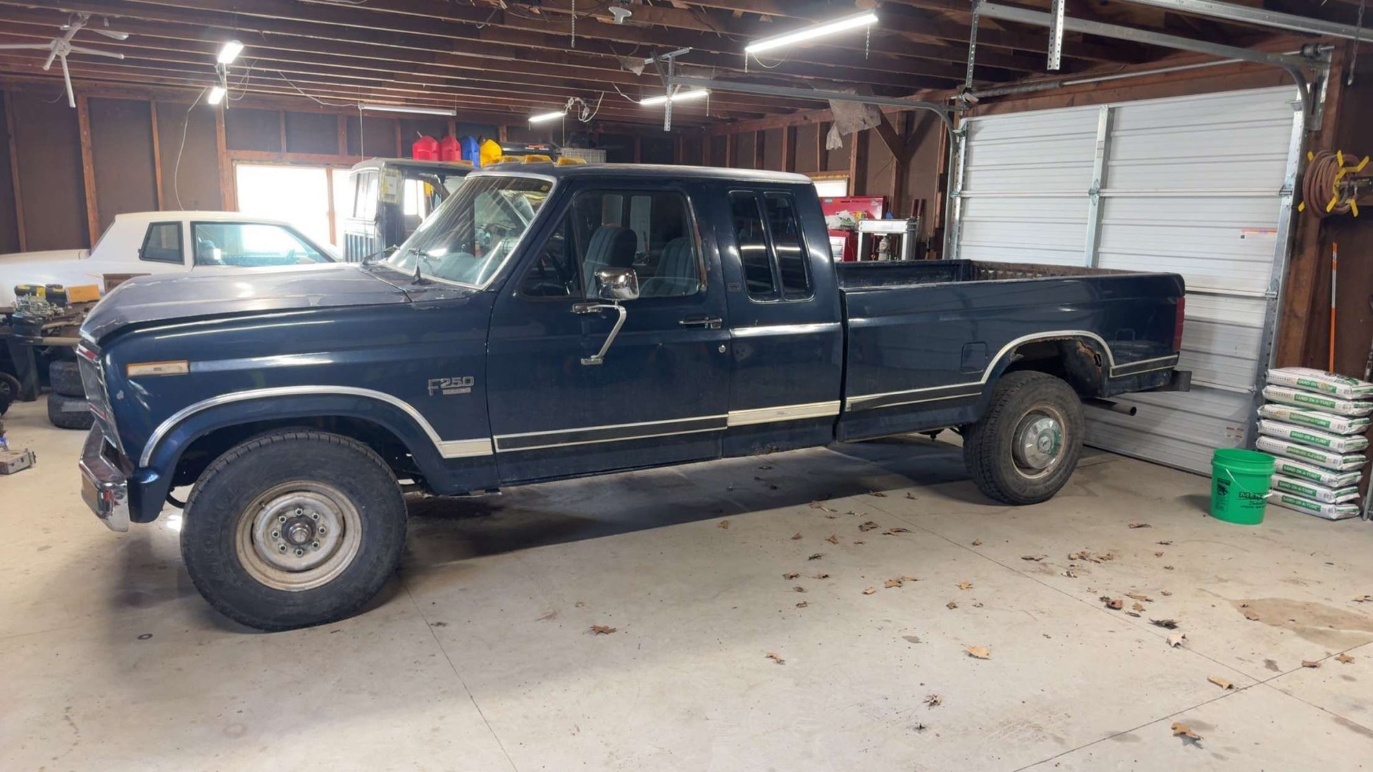

Hello yall,
I bought a 1986 f250 2wd with the 460 a couple years ago and i eventually blew the motor up so i decided i wanted to 4wd swap it. I bought a 1991 f250 4wd with a efi 460. I have the full wiring harness from the 1991 since it was a running and driving truck (body was rotten so I didn’t feel guilty about parting it). I have my 1986 cab on the 91’ 4wd frame.
my main question is what out of the efi harness do I need in order to make the 460,e4OD, and transfer case all work with my 86’ cab.

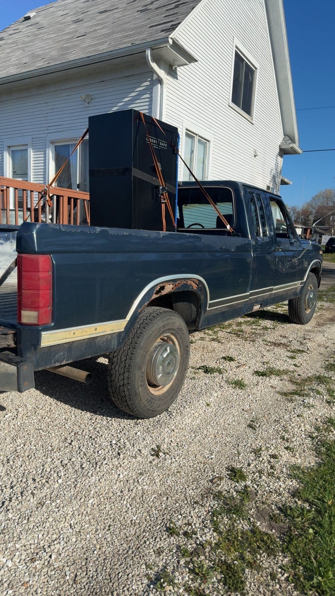

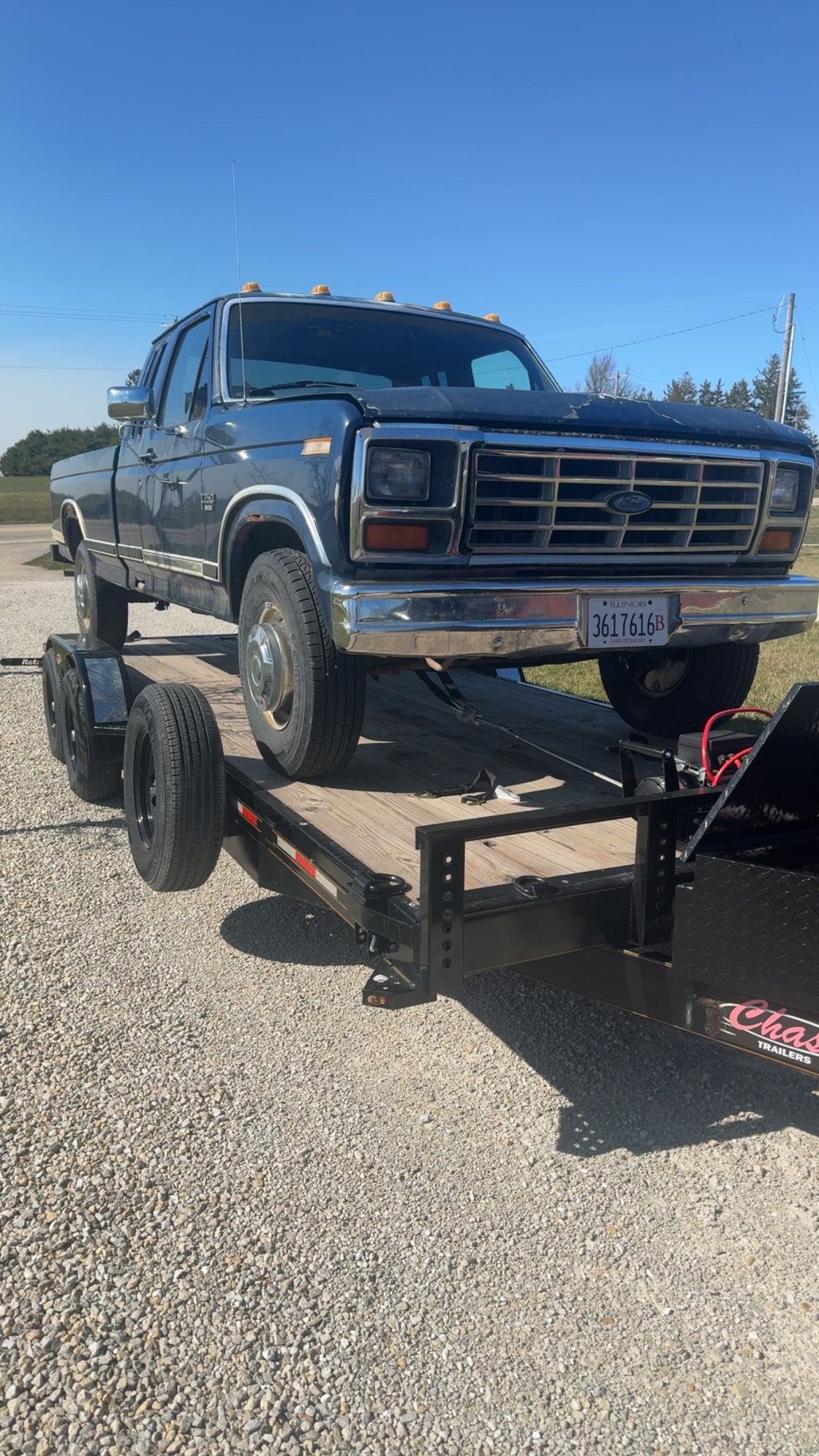

some pictures of the 86’ because why not.
