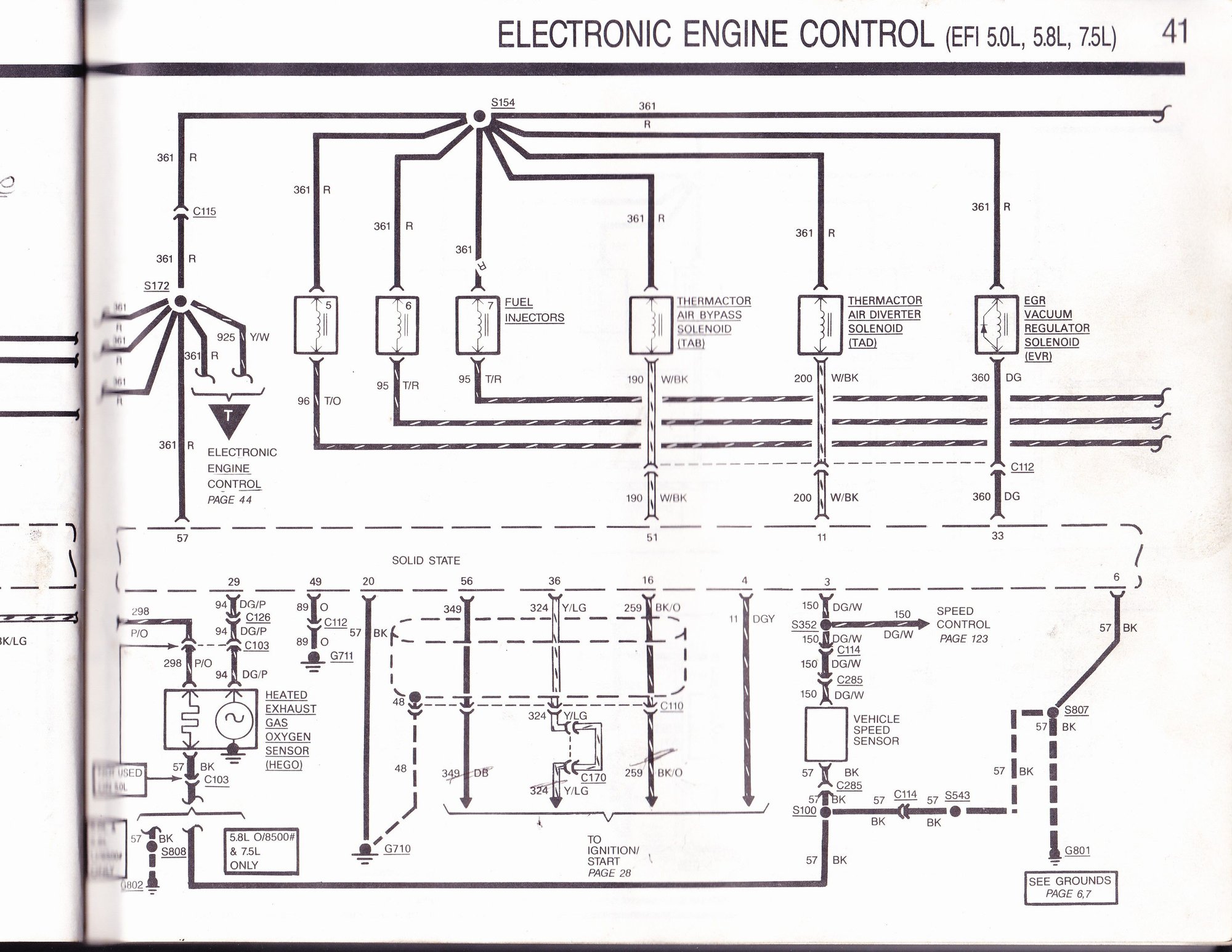

Hello all you Ford lover's! I have a 1989 Ford F250 460 EFI that I have revived from the dead and Im down to the last few issues, most everything is new and has been checked and double checked for trust ability.
I'm in need of a schematic for the fuel injection harness coming out of the ECM.

See attached schematic drawing.

This one may be a little better:

This one is from my 1989 F150 EVTM
