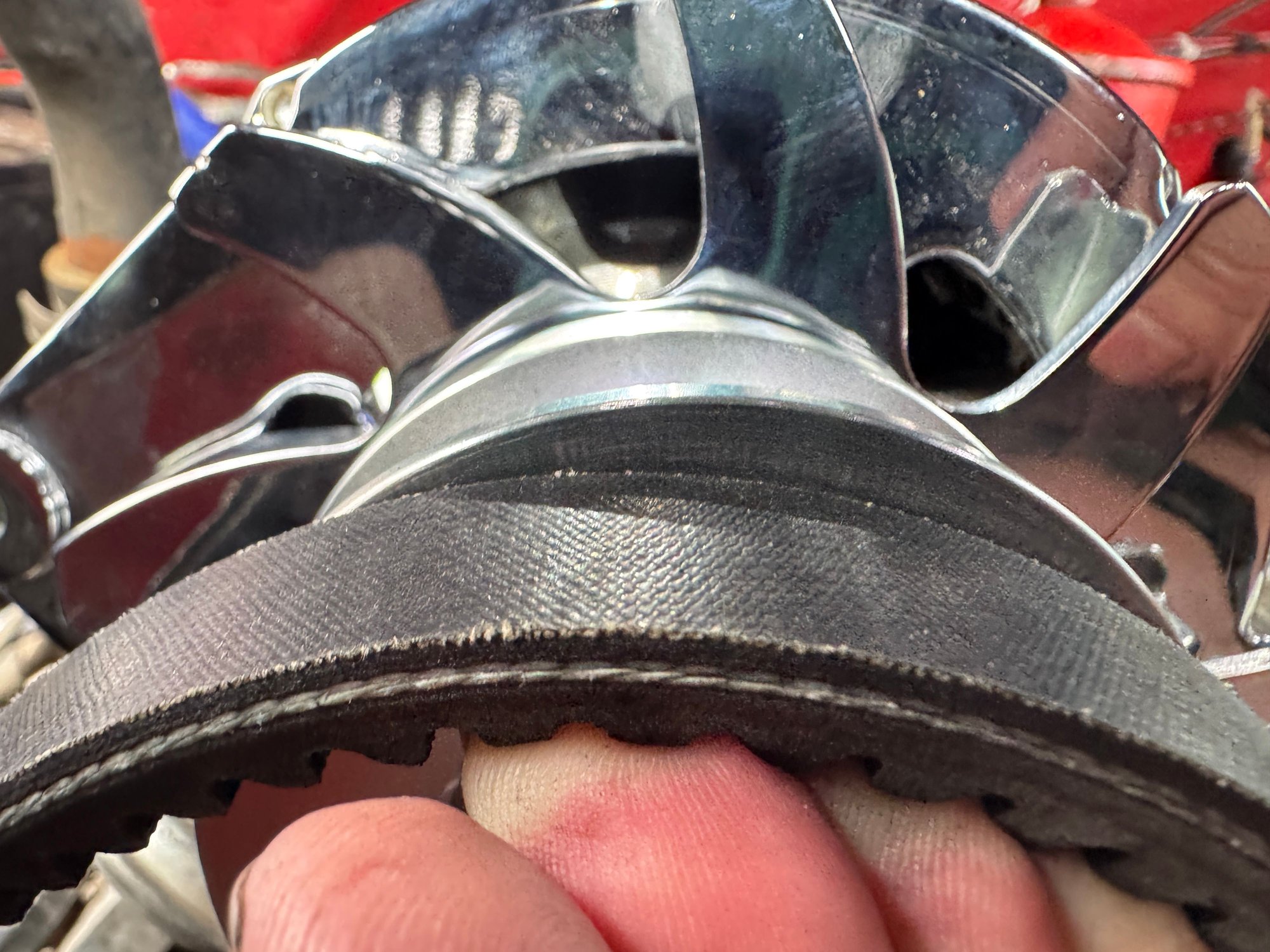

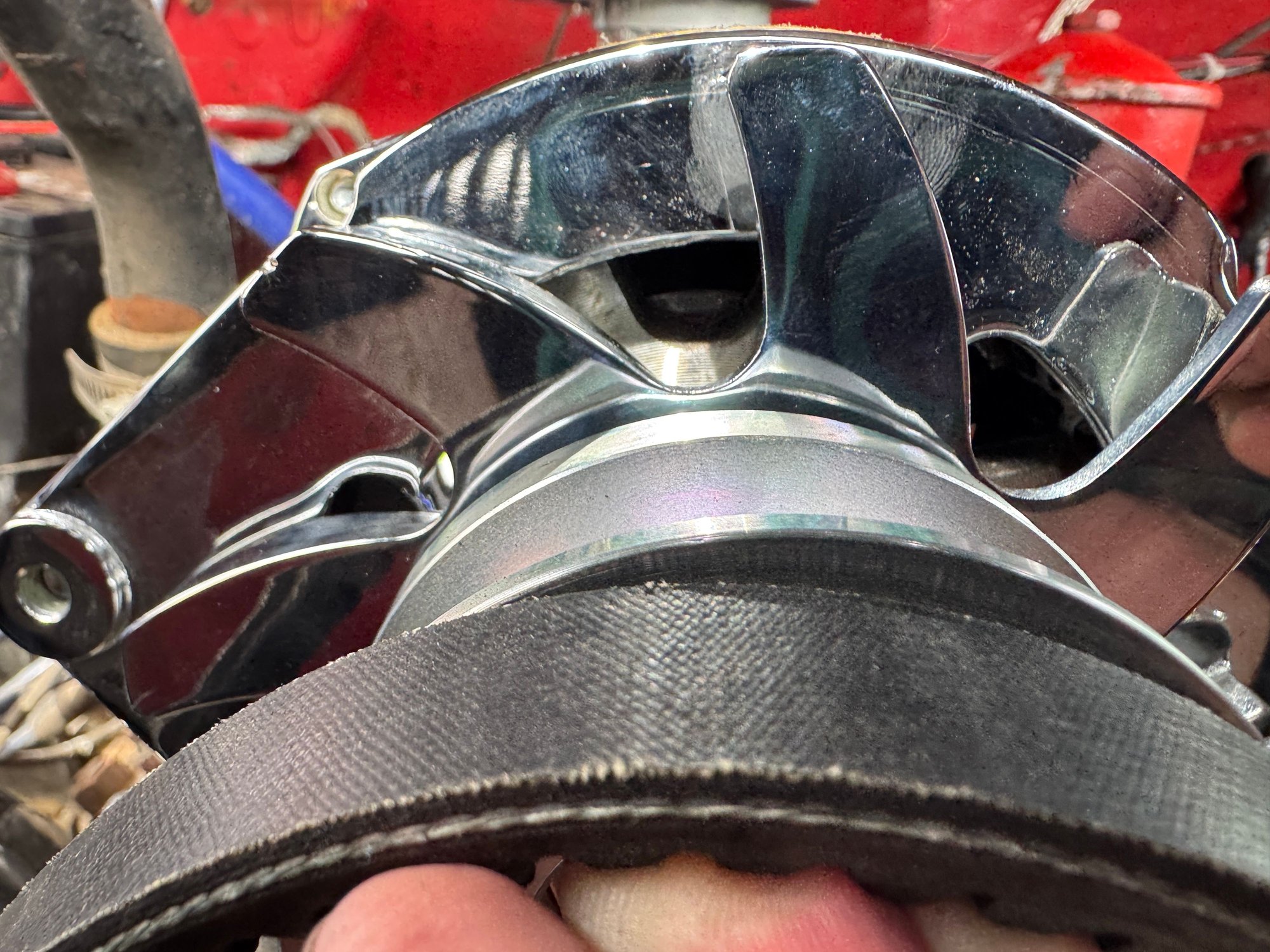

Swapped a Delco 10SI onto my 8BA. I was planning to wait until I installed a dual carb manifold, but I didn’t want to keep putting time or money into a generator I wasn’t going to run long-term.
I didn’t cut any of the original generator wiring—just taped it up and tucked it out of the way so it can be reused later if needed.
For wiring, I ran 4 AWG cable with 125-amp fuses on both ends and tied it into the starter solenoid on the battery positive side.
For anyone running a Speedway adapter with a 5/8” wide pulley setup: I had to switch belts. The Napa 25-20544 I was already using was too short, so I went with a 25-22553, which is a little over an inch longer. I still had to loosen the alternator mounting bolts and tip it in to get the belt on, but it was in stock locally so I didn’t have to wait.
Right now there’s about 1.5” of belt deflection (started closer to 3”), and I still have a bit of adjustment left in the bracket. Hoping once the belt stretches in, it’ll settle where it needs to be.
Voltage-wise, I’m seeing 14.72V at high idle right after a cold start. After about 15 minutes of idling, it dropped to around 13.8V.
This setup should let me run a Pertronix ignition along with additional brake lights and turn signals without worrying about overloading the system.
