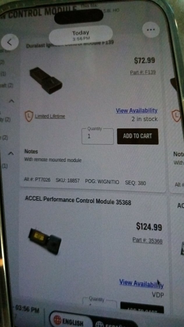

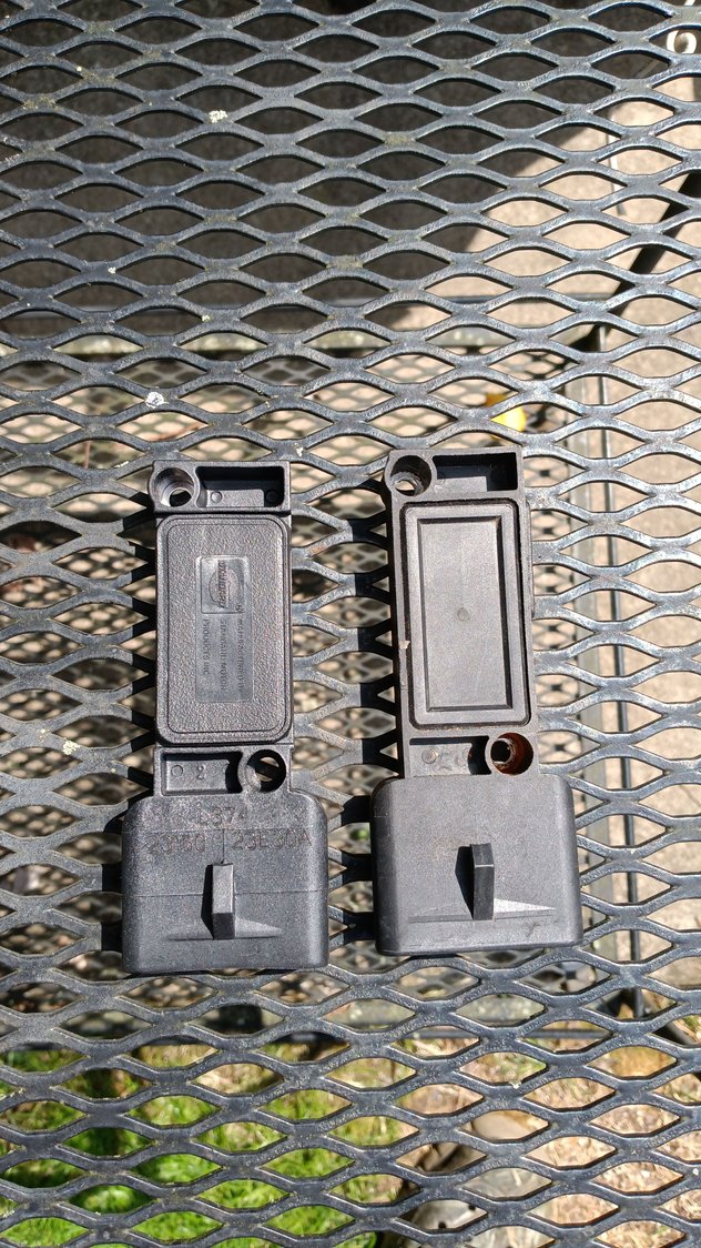

Lost my post dont know how so here we go again I thought I mentioned that I had new distributor installed by dealership couldn't find it anywhere but it is on work performed by dealership that I posted called dealership about getting a new ICM of course they said it's discontinued so I asked what they would recommend and nothing really except usual parts places then I said so if I took it to dealership and told you to replace it where would you go,then he said O'Reilly's so I went there and got one for $72 plus taxes,wire wheel heat sink reinstalled it , connect battery cable start it up and NO CEL on Yay. Pictures of old and new ICM and box part number in case it might help someone else,O'Reilly's says it's an accel but box says standard drove it couple hours today and no light on anymore
Thank you all for your help in patience plus one shop wanted $450 just to do diagnostic.

Did you use THERMAL PASTE between heat sink and Tfi? Dielectric grease is what comes with it, that’s for the connector.
If not, please get some, remove the dielectric grease and put thermal paste.
Arctic silver is a brand for reference.
