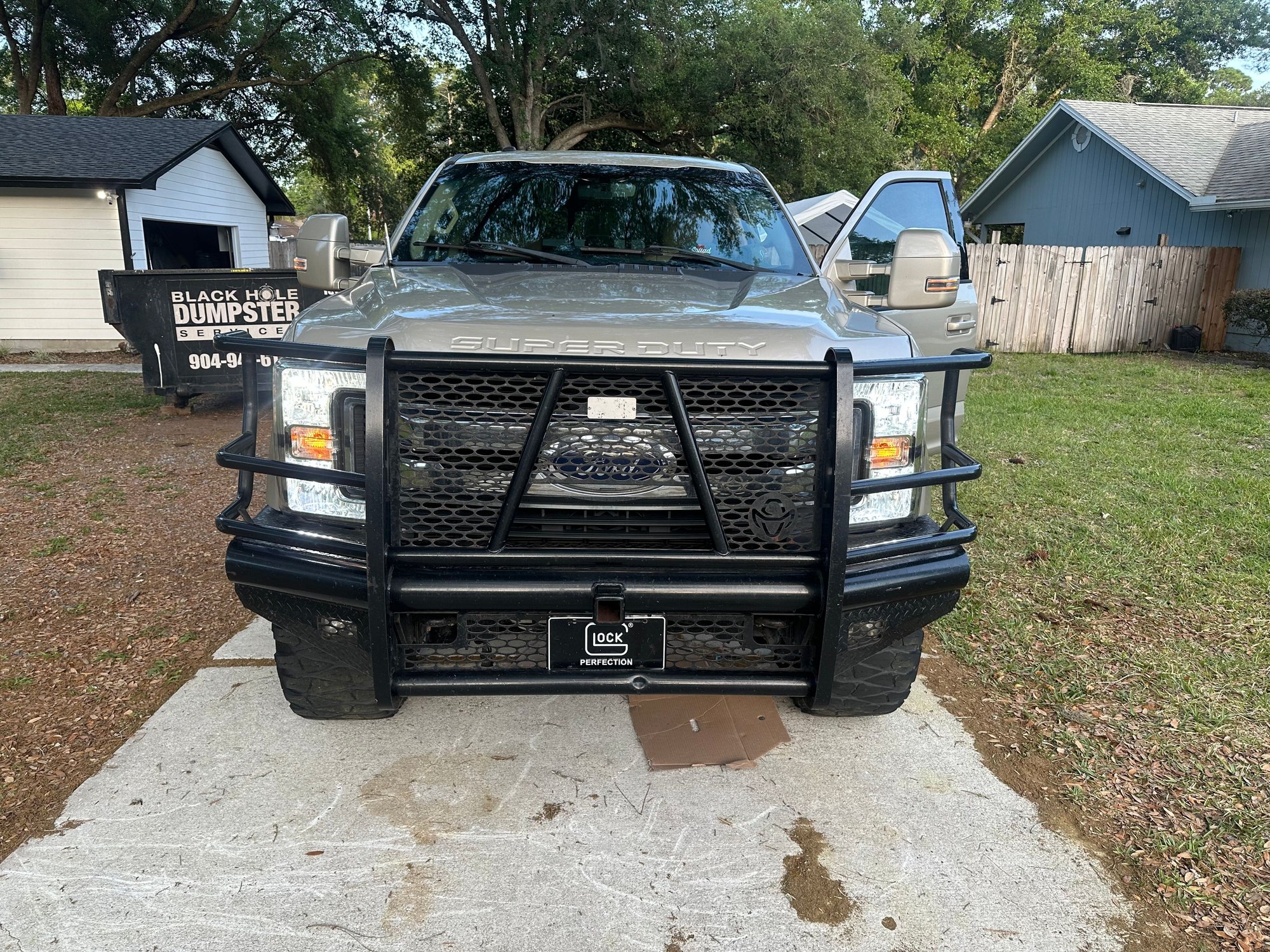

Don’t think these are original. But issue is on just regular headlights the bottom right and top left are lit up. When I hit the brights all 4 light up. Not sure what it’s supposed to be or if it’s a wiring, bulb placement, or bad light issue. Just trying to get some input before I pull the grill off, headlights, and try to fix it.

All four bulbs are dual function hi/low beam. You have the low beam filament burnt out in two of them.
I’d replace all four while in there. Surely there’s a way to get to them without removing the grill guard bumper. Look at pulling batteries and maybe the washer reservoir fill neck. Or you might be able to get there by peeling back the fender liner. I haven’t had to replace any of mine yet so don’t have first hand knowledge.
