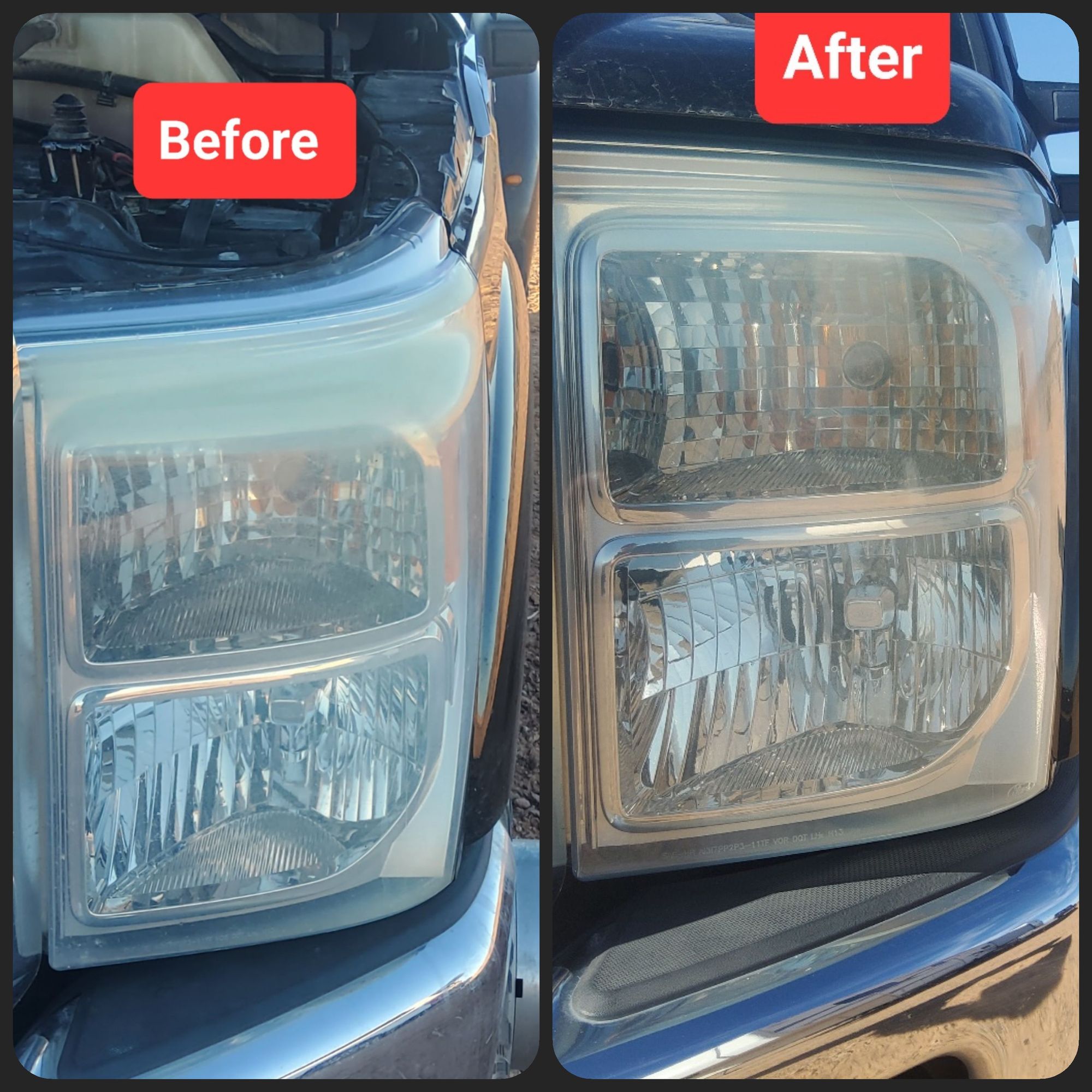

My 2016 head light where starting to yellow some and nighttime lighting was just horrible. This morning I figured to try a restore kit and this one seemed to get good reviews/ results.
Here are some before, during and after. The after is deceiving because it looks more yellow but it's the sun hitting them. There is still a little discoloration on the upper driverside which is inside the plastic I believe. Tonight we'll see if its better. Maybe it's time to replace the bulbs also? It's been 10 years, some new Sylvania Ultra Silver Stars are in order.

Took the grille off to get to the headlights. Removed the 4 10mm screws holding the light assembly on. Changed the bulbs to some Sylvania ultras. 30 minute job.

It's not perfect and I probably could of done a better sanding with the 2000 & 3000 grit discs. In the dark now though a world of difference. New bulbs probably didn't hurt either.
