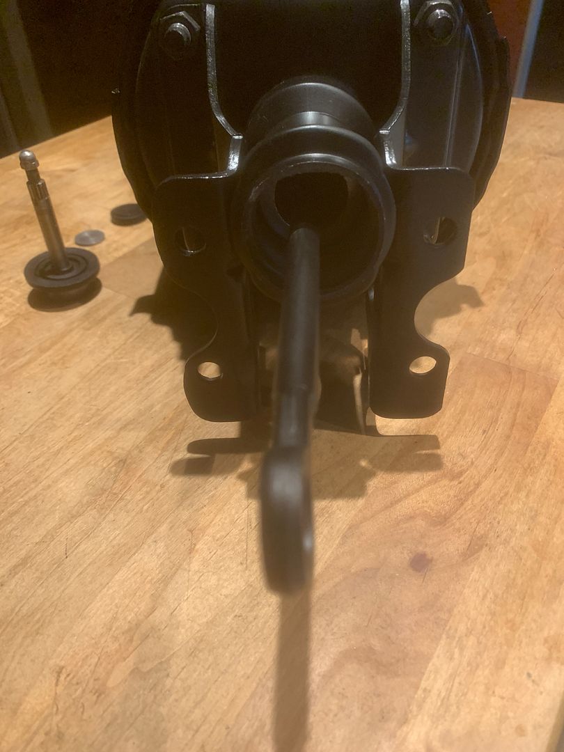

The original bracket I had looks like the one in the upper picture. I had to dig pretty hard but I found a video that shows how to mount the kit I bought, I’ll post it here for anyone that may need it in the future.

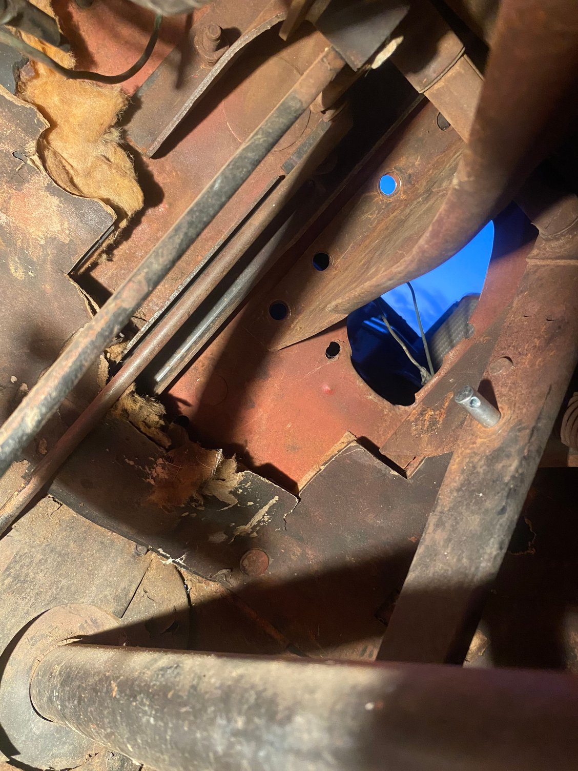

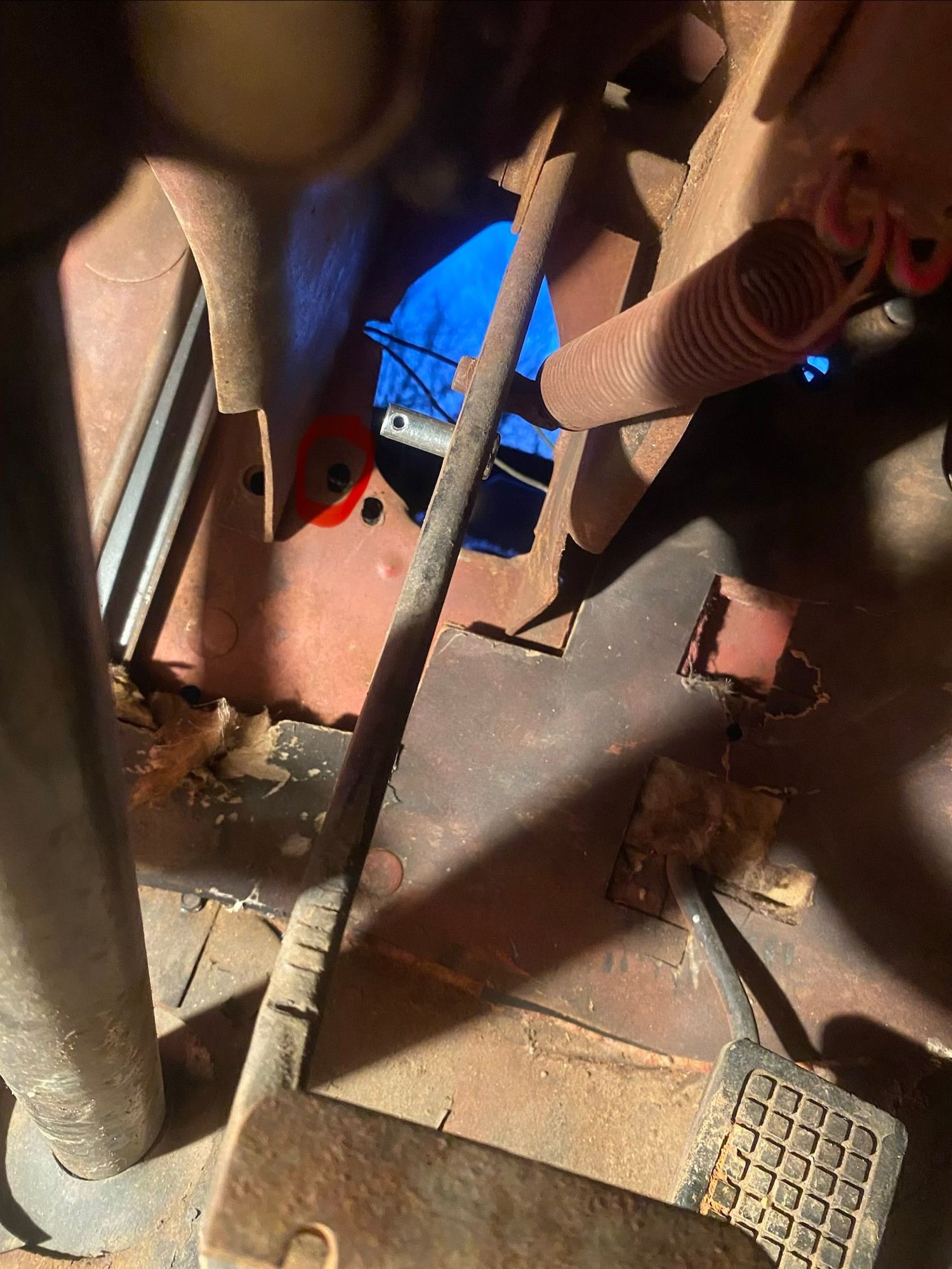

Well, I’m kinda back at square one. Upon looking at the video closer I noticed that the guy in the videos’ bolt holes go through the firewall inside of the steering column support, my old bracket was mounted through the steering column bolts. My holes are also too far apart to fit the bracket, the old bracket had a piece bolted on to bridge the gap. This must be another part of this truck that was rigged and cobbled together by the previous owner. My plan is to weld a patch and drill new holes, but I need a measurement to base them off of. There is one hole that someone has drilled that I assume was an attempt to do it the right way so I’m planning on basing the position of the other holes off of it. But I want to make sure it’s in the right spot. If anyone has a 1965 f100-350 can you measure the distance from the steering column support to the bolt holes? I’ll circle the bolt hole I’m talking about in red.

One thing you need to realize is a 1965 F350 is more akin to a 64 F100/250 than it is a 65 F100/250. Here is a thread to read thru with pictures the last post may help solve your problem.
Sorry I lost the link to that thread, but the guy ended up using a booster/master from a 1985 F350 with some small modifications.

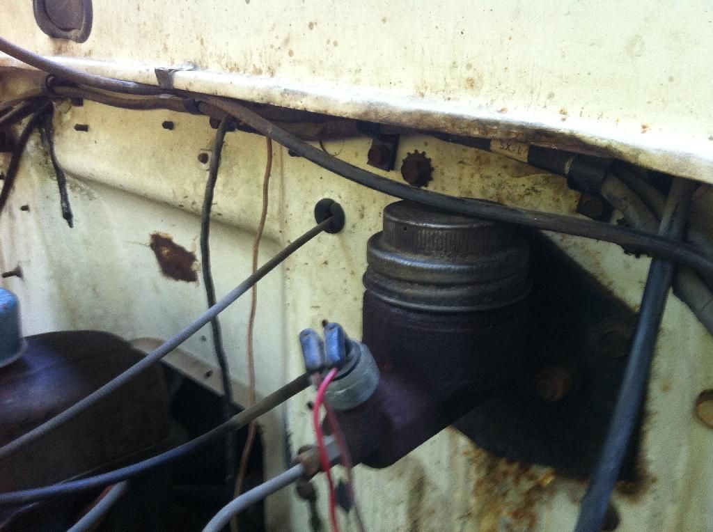

I found that thread. It has some good pics of the original boosters. Hackjob or not hackjob - Ford Truck Enthusiasts Forums
I looked and there are a few out in the salvage yard world, but they would likely be nothing more than cores.
@OldFerd352 Your best bet is to just go with the plain old original single pot master.

My own 1966 F250 4x4 trucks which are more similar to 1961-1966 F350 use a heavy plate over that general area and the single pot master attached to the plate. Some older pictures showing that.
